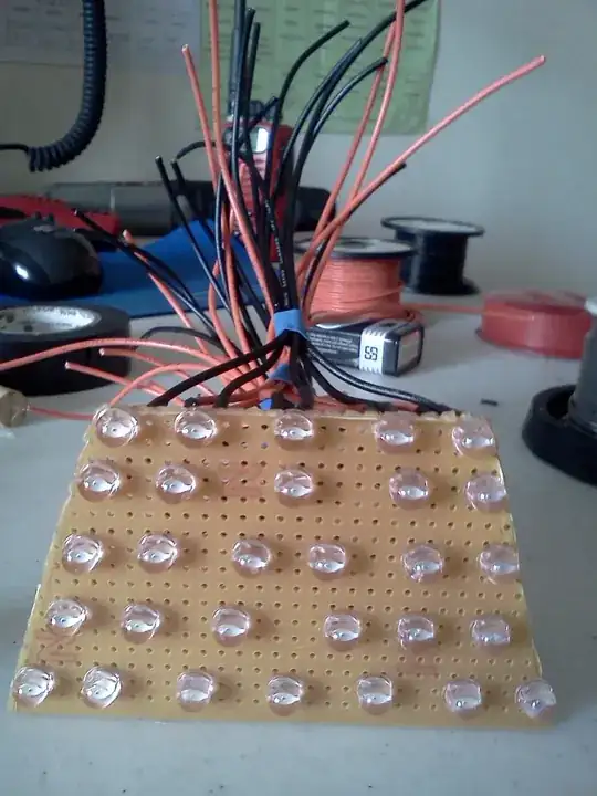

About a week ago, I have been soldering exactly 29 LEDs to a PCB in an effort to replace my old, custom taillight bulb that came with my motorbike since I bought it. I have successfully managed to solder the LEDs onto the board and I already did the wiring. Since I bought my LEDs on an electronic market, and they did not come in a package, I have no idea exactly how much voltage they need nor how much AMPS they require. Since then I have been trying to hook them up to multiple voltages including 3v, 6v 12v(which will be the voltage used by my bike.) I have also been researching about my issue and believe that my problem has to do with some form of resistor I will be needing.

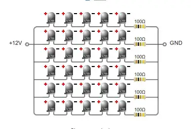

To wire ~30 LEDs at 12V (bike voltage) use the following wiring diagram:
You will need resistors to limit the current. Using the resistor value of 100 ohm will limit the current to ~15mA (chosen arbitrarily as you don't know how much current your LEDs will need) per LED (@ 5 LEDs in series).
The brightness of LED is dependent on the current flowing through it therefore you would have to experiment with the amount of current as you don't have the DATA on the LEDs. To increase the amount of current through a LED you would have to decrease the series resistor.

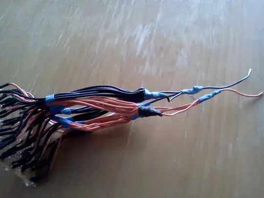

  • Thank you for the detailed answer, since I have already soldered everything into place, would it be possible to only use a single 100ohm resistor attached to the wire coming out of the wire bundle? – David Feb 11 '13 at 06:20
    @David - no. You would need a different value, higher power resistor, and it's a really bad idea, as you can get uneven current-sharing between the resistors. – Connor Wolf Feb 11 '13 at 06:24
    @David, that normally isn't a good idea because of manufacturing differences between devices. Just as a side-note if you do have 30 standard LEDs you might be disappointed with the light output, it might not be bright enough to be legal / safe. – PeterJ Feb 11 '13 at 06:25
  • @David Post your connection diagram. – Chetan Bhargava Feb 11 '13 at 06:26
  • Ok, so I should use 5x100ohm resitors for each of my five rows of LEDs? on which wire should they be connected, the positive or the negative?-should I then merge all the wires back together to form one pos. and one neg. wire? Would this be a good idea? – David Feb 11 '13 at 06:30

  • @David use the connection diagram I posted. Be advised that you would have to experiment with different values of resistors (for brightness) as you don't have the mcd (millicandela) information on the LEDs. – Chetan Bhargava Feb 11 '13 at 06:35
  • OK, so what would be an appropriate range onward that I should experiment with? 80-100ohms? – David Feb 11 '13 at 06:37
  • Chetan Bhargava, the GND in your diagram represents the negative wire, am I correct? and I should connect my resistors to the negative ends of the LEDs? from looking into the internet, other people connected it to the positive end, does this make a difference? – David Feb 11 '13 at 06:45
  • @David Yes, the GND in the diagram posted is to be connected to "-". It doesn't matter which side the resistor is connected. Look at this post – Chetan Bhargava Feb 11 '13 at 06:51
