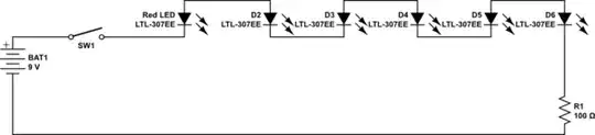

I want to wire 6 LEDs together 2.75" apart; I'm using 2V red LEDs. I've also already calculated the resistors I need.
I'm thinking of making 2 separate circuits of 3 LEDS with each having their own 9v battery, if that makes it easier to do rather than 6 LEDS on 1 9v.
What exactly are the steps to get this done using a switch in between as well.
As of now my plan is: ( I Tried drawing a diagram here)
Wire postive end of 9v battery to a switch, then from there connect the switch to the first LED, using copper wire, i'd solder the wire to each consecutive LED, until I have all 6 connected. The from the last LED I'd connect the negative end to a resistor, and finally add a wire connecting the resistor to the negative side of the battery. Would this work?

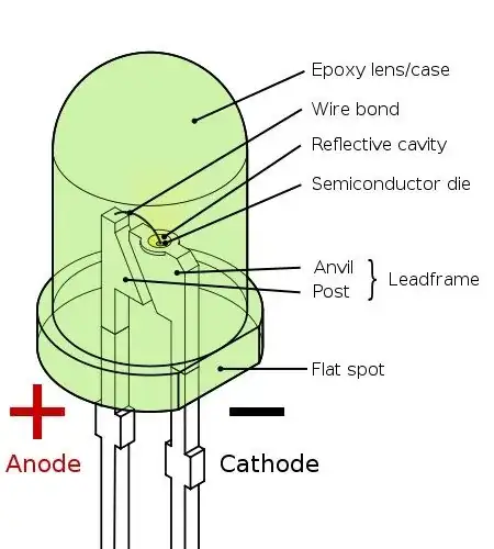

LED Polarity:
Polarity

    That's a very nice image illustrating the parts of an LED. – Magic Smoke Mar 18 '15 at 19:01
The schematic you showed won't do what you want. Notice that every other LED is reversed. LEDs need to be forward biased to make light.
Another issue you are ignoring is that the voltage of all the LEDs in series is more than your battery. You want to light 6 LEDs, and you say these drop 2 V each. With all of them in series, they would need around 12 V.
A simple solution is to arrange the LEDs in two strings of three each. In each string, there are 3 LEDs in series. That means a string will require around 6 V.
Let's say you want 20 mA thru each LED, which also means thru each string. With 9 V, there is 3 extra voltage to drop in addition to the 6 V dropped by the LEDs. This can be done by a resistor. You know the voltage across it will be 3 V and the current thru it 20 mA. By Ohm's law, the resistance should be (3 V)/(20 mA) = 150 Ω. Each string should have its own resistor.
Run two strings in parallel from the 9 V battery. Each string will draw 20 mA, so both together will draw 40 mA. A 9 V battery can handle that for a while.

No. You have a total Vf of 12V, but a supply of only 9V. You will need to create 2 parallel chains, and use resistors to limit the current through each chain.

  • Sorry I'm still learning this stuff.
    So are you suggesting I create a 2nd circuit with another battery? so it's 3 LEDS to one 9v battery?
    And so other than my power supply, does the rest of my plan make sense? location of toggle switch and using copper wire to connect LED's?
    – Roda Medhat Oct 18 '13 at 05:12
  • They can't use separate batteries if they're in parallel. – Ignacio Vazquez-Abrams Oct 18 '13 at 05:20
  • No. You should connect two sets of < three LEDs and a resistor in series > in parallel, with the switch in series with that (and we would usually put the resistor at the positive terminal of the battery, but it will work either way.) – Peter Bennett Oct 18 '13 at 05:21
