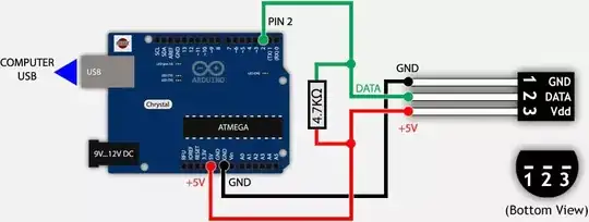

Edit Here's a schematic from a site which uses a resistor. The only difference is my board has VCC, one site said to connect VDD on the sensor to VCC, this one shows it connecting VDD to 5V. I'm not sure the difference schematic

    That's actually a wiring diagram (and some of the folks around here call them cartoons) but it will suffice as the schema can be seen since everything is labelled. 5 V should be fine for Vdd. The resistor is a "pull-up" to pull the data line high if none of the chips are pulling it low. – Transistor Jul 16 '17 at 22:32

The control line requires a weak pullup resistor since all devices are linked to the bus via a 3-state or open-drain port (the DQ pin in the case of the DS18B20).
This pullup may also provide parasite power. Figure 1 shows a 4.7k resistor between V_PU and DQ.
Additionally, also from the datasheet:
The 1-Wire bus requires an external pullup resistor of approximately 5kΩ; thus, the idle state for the 1-Wire bus is high.
That should answer your second question. To answer the first question, it's likely because it's a tutorial for using a TMP36 temperature sensor, which is completely different than a DS18B20. The TMP36 is an analog output temperature sensor, the DS18B20 is a digital temperature sensor that communicates via the 1-wire protocol (proprietary to Maxim), and consequently, there is really nothing in common between those two sensors. You will want to use a library that implements the 1-wire protocol to communicate with that sensor.
