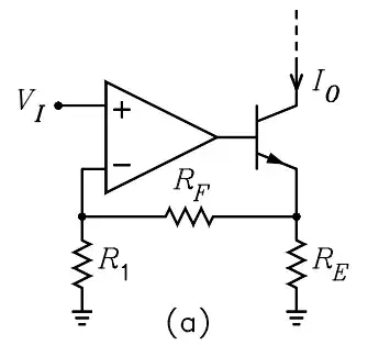

The third method I can use a opamp and a BJT like so:
But it too is highly dependent on that Beta value.

    Your third method is NOT highly dependent on the Beta value. The negative feedback of voltage accross R_E makes Io proportional to Vi (it is still very little dependent of beta because base current also flows through R_E; but this problably can be negelected; using a Darlington transistor would reduce this little effect further). – Curd Feb 01 '13 at 10:30
  • Using Darlington is a good idea, because power transistors don't have good Beta values. But is 5A not too much for Darlingtons? How much power will it dissipate? – Ender Wiggins Feb 01 '13 at 10:45
  • I did some digging around - I take it back, I found Darlington transistors that can handle up to 12 A – Ender Wiggins Feb 01 '13 at 10:54
  • e.g. BDX68: beta > 1000, I_C_max = 25 A, P_diss_max = 200W. "How much power will it dissipate?" only depends on your supply voltage, your load, your R_E and of course I_C. – Curd Feb 01 '13 at 11:13
