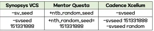

I know 3 EDA companies handle with SVSEED as the below image, enter image description here For reproducibility and random stability, I'd like to generate a random value by using "+svseed random" in SystemVerilog Cadence simulation as the below example snippet code,

    FYI, you have VCS and Questa switches swapped. – dave_59 May 24 '21 at 17:06
