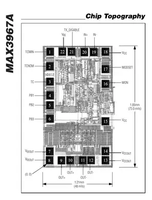

Consider the Max3967A from Maxim Semiconductor.
If you want to buy the conventional packaged version the part number is MAX3967AETG+, but if you just want the raw microchip inside (no package) you want part number MAX3967AE/D.
In the catalog the "package" for the "/D" version will be "DIE" -- meaning no package.
From page 12 of the datasheet:
You can see they dimension the die in the drawing for you. You will need access to a wire bonding machine in order to use a raw die (among other things).

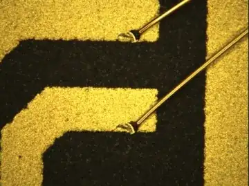

In this microscope image, you can see two wires bonded (attached) to the package in the center.

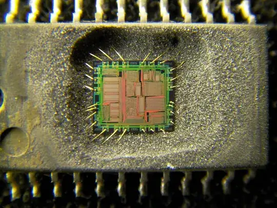

And in this photo of a thick-film hybrid circuit (taken with a little less magnification) you can see the wires bonded directly to the various die as well as the package forming the connections between the frame and the outside world:

    Your next photo isn't a monolithic IC at all, but rather bare-chip MOSFETs and other components soldered to a substrate, which is in turn mounted in a larger package. The MOSFETs have wire bonds to the substrate, and the substrate has wire bonds to the outer package. – Dave Tweed Jan 31 '13 at 13:47
  • @Dave -- Yeah it's a hybrid circuit. As you point out it shows the wide range of uses of wire bonding. – DrFriedParts Jan 31 '13 at 13:54

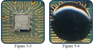

You have probably seen a circuit board for a cheap led screen and it has little black bulge... This is the kind of thing a 'DIE' package is used for. This is referred to as "Chip on Board" as shown below. The left image shows the die directly mounted on the PCB, with the bond wires connected to the copper traces. The right image shows the protective epoxy coating applied after the connections have been made.
Chip on Board
(source: elektroda.net)

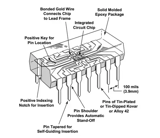

It would be the "Integrated Circuit Chip" in the picture below:
IC internals
