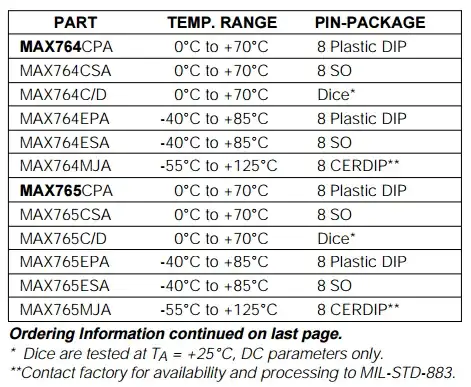

Looking at a datasheet of an inverting regulator, I found something peculiar:
Ordering information with strange Pin-Package
I've never heard of a Pin-Package called "Dice" before, and it doesn't even specify the pin-count. On the package information site of the manufacturer, this package isn't mentioned either.
What does "Dice" mean in this context and why would I want to use it?
iFreilicht
  • 671
Strange naming convention for loose chips, i.e. dies from the silicon wafer with no package.
You want to use it if you are assembling your own custom IC with this device built into it. Flip-chip straight on the PCB comes to mind as well, but the die has to be made for it in the first place.
