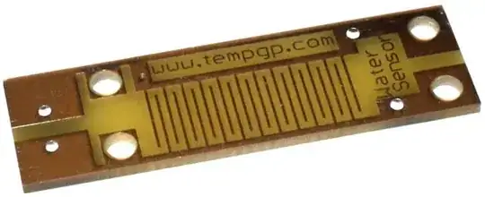

At the simplest level are electro-conductive sensors, essentially a pair of zig-zagging exposed conductive traces along a PCB, with a small gap between the traces. If the device is submerged in water, there is conduction between the traces, which would indicate presence of water. Of course, the traces must not be covered by solder mask. Conductive Strip water sensor
From this site
Since the conduction of electricity through the water is dependent on electrolyte / ion content in the water, results vary depending on the water quality. Further, due to corrosion and oxide build-up, the longevity of these sensors is very limited.
If the water tank in question contains somewhat impure water, then a long strip, or several short strips, of such sensors made of standard PCB may serve the purpose. Since the "sensor" is inexpensive to make, regular replacement is an easy recommendation.

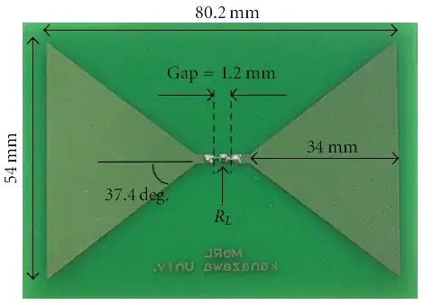

A variant on this theme is the use of microstrip antennas, essentially the same concept of PCB traces, but designed to be energized via a radio frequency signal. As the dielectric between the two conductors varies with humidity, moisture and of course submersion, the resultant change in antenna load can be used for detection. See this publication for additional information.
Microstrip Antenna on Glass Epoxy PCB

Surprisingly I stumbled on the image of our water sensor (I'm the owner of TempGP). Just to add to comments about our sensor plate, their galvanization (transfer of ions from one side to another) to avoid that variable/ alternative current can be used there. Also in our V3.0-B version we planing to use an ultrasonic sensor to detect distance to the water source, this will allow corrosion resistance and the sensor can be adjusted to tank specs.
