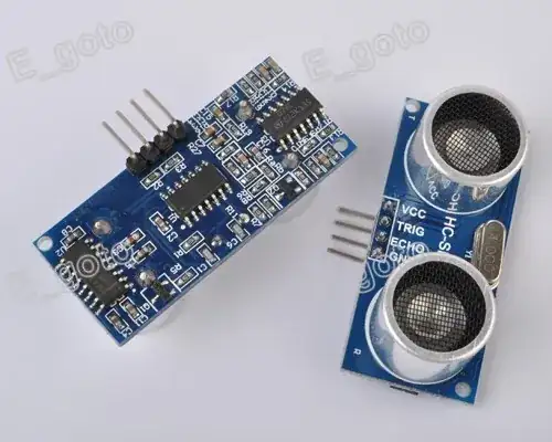

The budget approach involves modules such as this one:
Ultrasonic Sensor (From eBay, for under $2)
Rather than deploying the module as-is, the module can be potted using epoxy potting compounds, covering everything but the tops of the ultrasound transmitter and receiver and the connector pins. Better yet, suitable weatherproof cabling can be connected, and the junction also potted. This promises reasonable longevity.

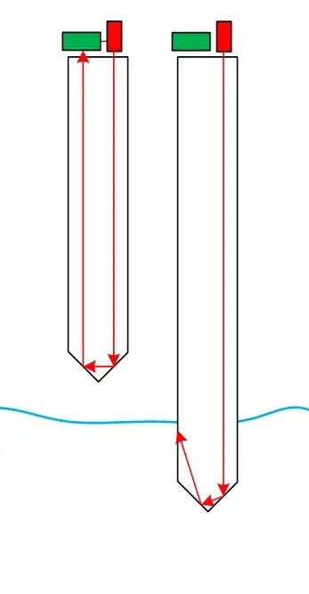

2) You can place plastic rods that stick down into the tank at different depths. Each plastic rod has its end cut off at a 45 degree angle from each side and then polished to a very smooth finish. A light beam shines down into the rod from the top (could be an LED visible or infrared depending upon what is suitable to the materials you are using) and normally reflects off the two bevels at then end of the rod and is reflected back up to the top of the rod where an photo diode or photo transistor is used to detect the reflected light. When water in the tank rises up and covers the beveled end of the rod it changes the refraction index at the end of the rod and the light coming down no longer fully reflects back up to the detector. The assortment of rods can tell you where the water level is. The picture below shows the concept involved. It would be fun to experiment with this concept using a cheap laser pointer module as the light source. (Back when I worked with this concept years ago there were no laser pointers!!)

    @icarus74 - The thermistors would need to be exposed to the cooling medium of the water. Since they are being run in a self heating mode by a little current being run through them the less thermal barrier between the part and the cooling medium the better. I did this some years ago and yes the thermistors and their attached insulated wires were encapsulated in a thin layer of epoxy. Yes you would have one thermistor for each sensing level. – Michael Karas Jan 18 '13 at 13:30
    @icarus74 - The plastic rods are not pipes. They would be clear solid plastic rods maybe 0.5" to 0.75" (~12.5mm to 20mm) in diameter. I've added a small graphic to my answer. The polish is added to end of the plastic rod where it is beveled. – Michael Karas Jan 18 '13 at 13:34
  • Wish I could vote-up further for the nice illustration, and very creative (and fun) looking method. As for the plastic rod, I believe you meant something like clear acrylic ones ? Extremely difficult to find those locally, else I might have given this a shot. – bdutta74 Jan 18 '13 at 14:38
  • And, I almost forgot how bad the quality of my water is, and the scaling (salt deposition) problem. I guess the 2nd method is prone to this problem. – bdutta74 Jan 18 '13 at 14:39
  • @icarus74 - Yes. Any deposits on the end-surface of the rod would negatively effect the sensitivity. – Connor Wolf Jan 19 '13 at 13:19

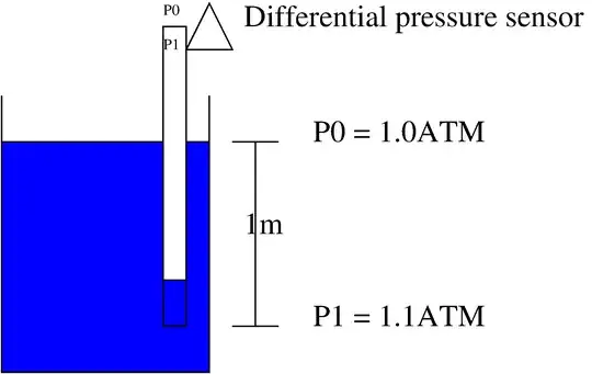

My suggestion is to use a differential air pressure sensor mounted in a pipe sealed in one end and filled with air, partly lowered into the water to meassure the water level.
One sensor inside pipe lowered into water
Assume initially that the the air pressure is 1.0ATM. Then the pressure in the water at 1m below the surface will be 1.1ATM. By lowering a pipe filled with air and sealed in the top 1m down in the water the water preassure at the bottom of the pipe will compress the air inside the pipe to 1.1ATM.
By mounting the pipe to a fixed position, different water levels will give different pressures inside the pipe. Since the sensor is differential variations in air pressure will not affect the sensor. I have no specific preference on what sensor to use, but the MPX2050DP sensor seems to be usable.
The only thing that could weaken the robustness of this solution would be if the fluid contained large objects that potentionally could block and seal the bottom opening of the pipe, however since the preassure is independent of the volume, you can use as wide pipe as you want to.
