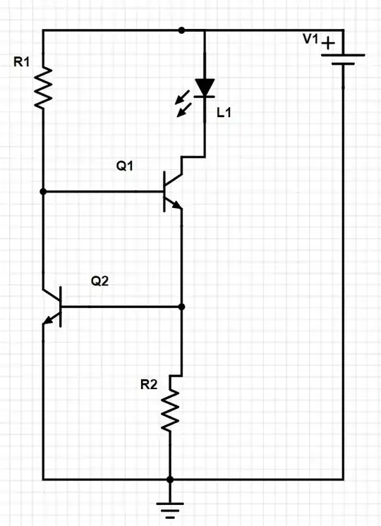

I read about a method of limiting current using 2 transistors (schematic attached below).
Source 1 http://www.physics.unlv.edu/~bill/PHYS483/current_lim.pdf
Source 2 https://www.homemade-circuits.com/universal-high-watt-led-current-limiter/
This would satisfy my requirements of being a cheap solution and using simple components. I have BC337 and 2N2222 transistors. I think the BC337 can handle 800mA, with hFE being 100-630 (info for BC337 here). In the sources, they use an hFE value of 30. How do I know what value to use?
Questions
  • How to choose hfe?
  • What values should be used for R1 and R2?
  • How much power will the BC337 transistor need to dissipate?
  • Is the sensitivity to temperature tolerable? (e.g. 0-30 celsius)
  • The ESP8266 can output a PWM signal. Would this be useful for the circuit?
Here is my attempt at a schematic. This doesn't yet incorporate switching using 3.3v logic from the ESP8266.
All linear solutions, resistor or whatever, will have the same efficiency.
If you run the LED at 1A, it will draw 1A from 5V, so that's 5W. If there's 1.6V across the LED, then there will be 3.4V across the current regulator (whatever it is) so the LED will get 1.6W and the current regulator will burn 3.4W as heat.
You could put two LEDs in series for a total of 3.2V and use a lower value resistor. So you use more power in the LEDs, and waste less in the resistors.
Or you could get a switching LED driver.

You have too many questions in one post, but I'll try.
You calculated the resistor dissipation as if it was the only load connected to 5V supply. The LED will drop about 1.5V so the resistor would not see full 5V. It would still dissipate a lot, about 2.45W.
Regarding the transistor constant current circuit, it still has to dissipate the exact same 2.45W. So just as inefficient than the simple resistor. Plus it needs some power to operate so it will be slightly worse than the simple resistor.
You can't really choose a hfe, you just get wildly different tolerance transistors from the factory, so in general a good design works with any hfe value the transistor happens to have. So R1 sets the current before Q2 turns on, assuming 0.7A limit and 0.7V at base, that's 1 Ohm. It will dissipate 0.7W then. This leaves about 2.8V over Q1 at 0.7A, about 2W dissipation - which the transistor can't handle, so you can stop calculating, as the transistor would burn up.
If it did handle the power, you would look from the curves that at 700mA the typical hfe is about 70, so with good margin, let's use 50 so base current available needs to be at least 14mA, and from the curves, Vbe is about 0.9V, and so Vb would be about 1.6V. Feeding 5V to 1.6V at 14mA needs about 240 ohms for R1.
The temperature tolerance would be about 2mV/°C tops based on curves so if it did work it would not drift too much.

    thanks for your response. I understand now - something has to disapatate that power, whether it's transistors or resistors. Regarding hfe, in Source 2 he uses hfe in the calculation of R1. He gives R1 = (Vs - 0.7)Hfe/Load Current. If I use the wrong value of Hfe, I'll get a value for R1 that will limit the load current to the wrong amount? So isn't the choice of Hfe quite important, to avoid blowing out the LED? – maurera Apr 16 '21 at 21:49
    No, like I said, a circuits that depend on a specific hfe values are bad, and this circuit does not because it uses negative feedback. As long as the circuit is designed to work with a transistor that has at least some minimum hfe, it will work. – Justme Apr 17 '21 at 09:00
You can halve your losses by series connecting two LEDs. This will give you a combined forward voltage drop of 2.8 to 3.2 V reducing your resistive losses from about 70% to about 40%.
  1. How to choose hfe?
Your circuit won't be picky about hfe. You just need to ensure that R1 provides enough bias to turn on Q1 to the maximum current required.
  1. What values should be used for R1 and R2?
R2 is easy. \$ R_2 = \frac V I = \frac {0.7} I\$. Q2 starts stealing the bias from R1 when it's base voltage rises to about 0.7 V.
Q1's base will be at about 2 × 0.7 = 1.4 V leaving about 3.6 V across R1. A base current of about 1/20 of the collector current should be adequate.
\$ P = VI = (V1 - V_{LED} - V_{R2}) I \$. i.e. \$ V_{Q1}\times I \$.
Is the sensitivity to temperature tolerable? (e.g. 0 - 30° Celsius.)
I can't think of a problem.
  • It would be useful for dimming.
  • Check the datasheet (ah, but I see AliExpress in your question links so I bet you can forget about datasheets), but you could allow a higher current if duty cycle is limited. This would help your efficiency.
