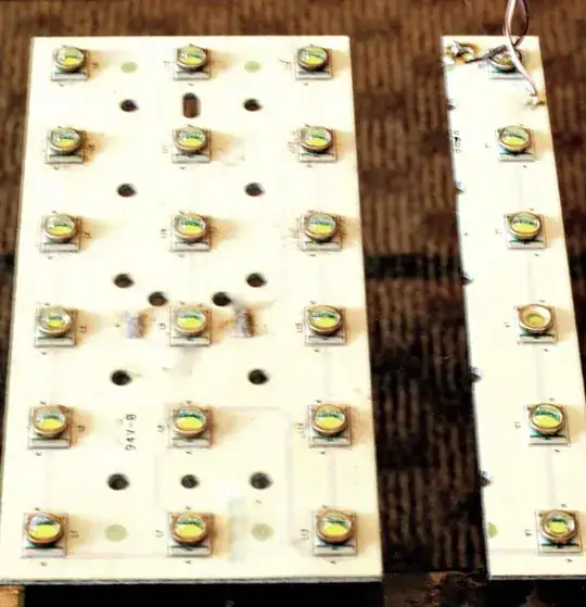

  • I use the 4.5A @ 19V ULC's for 6x1W white or blue on aluminum clad PWB's
  • Shown below with 6x3 serial string and 6x1 string on aluminum boards
  • I mount these under aluminum 0.5"x1" extruded end strips uses for tiles for elimination of LED glare and additional heat-spreading and the mount under exterior hand or deck rails.
  • Moisture protection is added and essential for external use.
  • Used 13 strings of 6 x 1W LED MCPCB's (78 LEDs) in parallel on 19V @ 4.5A (85W)
