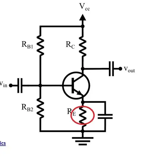

I'm struggling to understand the purpose of the resistor circled in red, I know it has something to do with DC biasing and the feedback on the circuit (as the capacitor will cause AC bypass). But I'm struggling to understand the exact circumstance where this would be needed. Is it a change in supply voltage, or change in transistor beta? And the exact mechanism that would cause the resistor to solve the problem.

    Just a couple of words to look up "emitter degeneration". Whole books could be written on the subject. – Lorenzo Marcantonio Mar 29 '21 at 12:56
  • Can I suggest changing the title to something like "Purpose of the emitter resistor". The fact that you have circled a component in your diagram is not really relevant to the title of the question, which people will see when browsing or searching. – Rodney Mar 29 '21 at 17:56

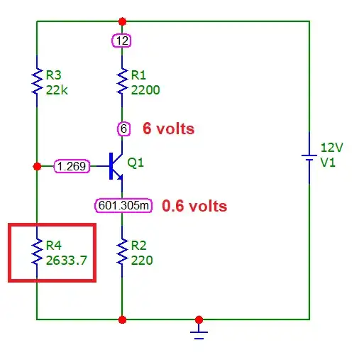

What most folk want with a common emitter amplifier is for the DC collector voltage to be about half the supply voltage. So, when you have an AC signal present at the input, the amplifier's output (collector) doesn't clip the signal asymmetrically. Another way of phrasing it is that you are aiming for a good linear dynamic range capability.
To achieve this, you need to create a situation where the DC quiescent collector current is held fairly constant. So, if Vcc is (say) 12 volts and Rc is (say) 2200 Ω then you want the quiescent current through Rc to be about 2.73 mA (2.73 mA through a 2k2 resistor drops 6.006 volts).
To ensure that a DC current of 2.73 mA flows through Rc consistently requires an emitter resistor. If the emitter resistor is 220 Ω (for example), a DC current of 2.73 mA flows from the collector into the emitter and then through the resistor and, it would drop about 0.601 volts across it.
It then follows that the base-bias voltage would need to be about 0.601 volts plus about 0.7 volts (internal base-emitter volt-drop). So, around 1.301 volts on the base will ensure that there is approximately 6 volts DC at the collector.

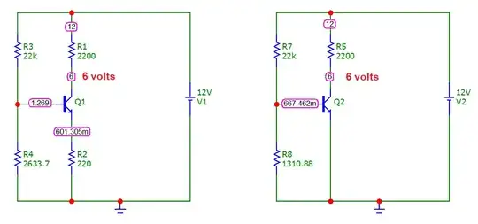

Knowing this allows you to calculate the base-bias resistor values. Here's a simulation where I've tweaked R4 to show what I mean: -
In this example I used a BC547 BJT and the base voltage to ground is 1.269 volts (implying that the base-emitter volt-drop is 0.669 volts). So, it's easy to follow and you should nearly always get predictable results but you'll never get exact results from a single BJT amplifier.
So, that's the normal case when an emitter resistor is used.
If you didn't have an emitter resistor, how can you properly define the current flowing in the emitter (and the collector)? Well, you can if you know the maths surrounding a CE configuration but, then you'll find that temperature effects will be surprisingly high and the desired 6 volts at the collector may drift with temperature a few volts this way and that way.

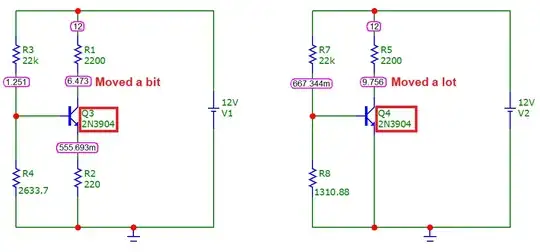

So, do you want a 5h1tty circuit that drifts around or, do you want a stable circuit?

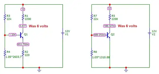

It's both and, it's also temperature and, it's also circuit repeatability. Here's a side by side comparison: -
And, if I increased R4 in the left circuit and R8 in the right circuit by 5% we would see this: -
Can you see that a very small change in the biasing condition hasn't really altered the quiescent DC voltage on the left-hand circuit but, on the right-hand circuit, the collector voltage has dropped from 6 volts to 188 mV. The right-hand circuit is very susceptible to component drift.

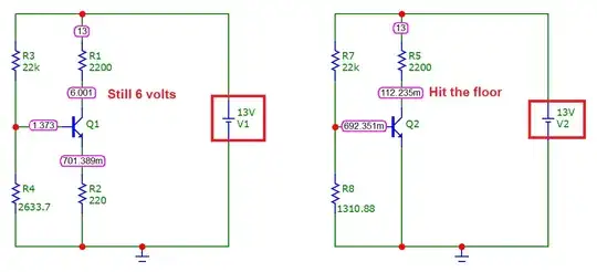

If I restore the resistor values and increase the power supply voltage from 12 volts to 13 volts here's what we see: -
In other words, the right-hand circuit is very susceptible to power voltage changes (and also component value changes). If I restore the supply voltage to 12 volts and change the ambient temperature in my simulation from 27°C to 37°C we see this change: -

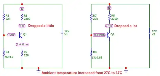

In other words, the right-hand circuit is very susceptible to power voltage changes, component value changes and ambient temperature changes. But, what if I swapped out the transistor with a 2N3904: -
The above has restored ambient back to 27°C but swapped the BC547s for 2N3904s. The circuit on the left is clearly more robust at dealing with this situation.

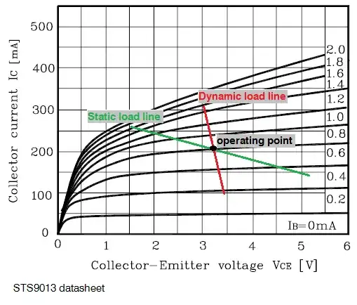

RE is needed to cope with the power supply voltage fluctuation, and it keeps the operating point stable.
For small signals, it will reduce the gain so a capacitor bypasses it for small signals. In other modes you have the same considerations.
Enter image description here
If you look at the static load line you will see that a variation of VCE does not result in a large variation of IC, so when the power supply fluctuates VCE changes, but the operating point does not move a lot.

  • @Paul, I can't agree with your last edit. When the power supply fluctuates, Vce follows its variations since the voltage drop across Rc is constant (because of the constant collector current). Re keeps stable only the collector current; it is not responsible for Vc. That is why this negative feedback is named "current-type". – Circuit fantasist Mar 28 '21 at 22:17
    @circuitfantasist you are right and that is exactly what I wrote. "Does not result in a large variation of Ic" maybe you didn't read the "not". I wrote also that Vce changes. – Paul Ghobril Mar 29 '21 at 01:32
  • @ElliotAlderson done. – Paul Ghobril Mar 29 '21 at 20:14
  • Is there a difference between "V CE" and "V ce" (e.g., DC vs. AC signals or small vs. large signals) or are they the same thing? Can you clarify somehow? – Peter Mortensen Mar 30 '21 at 15:35
  • I think "small signals" need to be qualified. It is not entirely clear what you refer to. E.g., small-signal modeling, the AC part of the signal (e.g., above a certain frequency, not just non-DC), or something else. – Peter Mortensen Mar 30 '21 at 15:41
  • @PeterMortensen it is about the operating point so it does not concern small signals. The dynamic load line is for small signals when the emitter resistor is bypassed. – Paul Ghobril Mar 30 '21 at 15:48

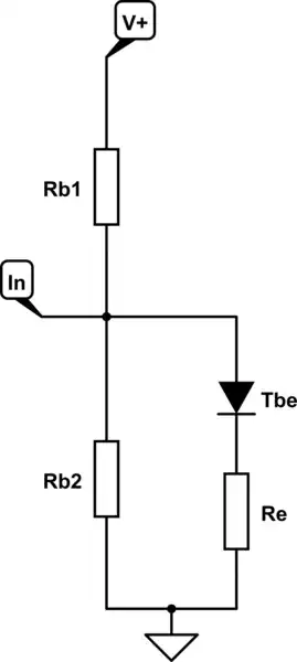

Look at the emitter circuit.
schematic
As soon the base-emitter diode reaches its forward voltage, the bias runs away. You cannot completely solve this problem as you want to have current running into the base. But you don't want to have a diode characteristic at that place. You want it linear. That's what the emitter resistor does. It lineriarizes the current through the BE diode. Same as a series resistor does it for any other diode. The circuit is now more stable against fluctuations of V+.
