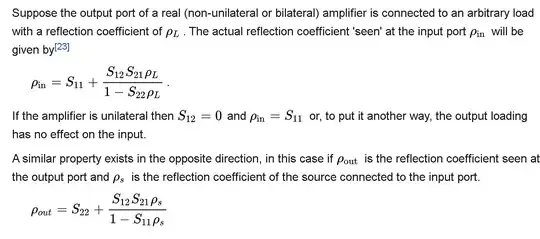

Below we see the S11 plot of a transmission line, the Wikipedia definition of the reflection coefficient as a function of S-params.
As I see it, the S-param frequency domain plot comes from the time domain steady state.
TDR is time domain in every moment from the start (transient).
So how can we convert from S-param (steady state) to TDR (transient)?

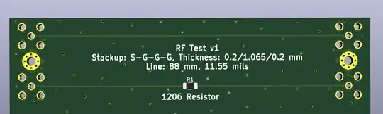

To evaluate the impedance discontinuity and signal integrity impact caused by a 1206 resistor footprint, I fabricated a test fixture shown in the picture below.
PCB test board

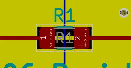

resistor footprint, with ground plane partially removed
It's a 4-layer circuit board with three solid ground planes. Two through-hole SMA connectors are located on both ends, with a 50-ohm microstrip in between. At the center is the Device Under Test, a 0-ohm, 1206 resistor. Also, to compensate for the excess capacitance caused by the large resistor pads, the ground plane under the resistor body is partially removed.

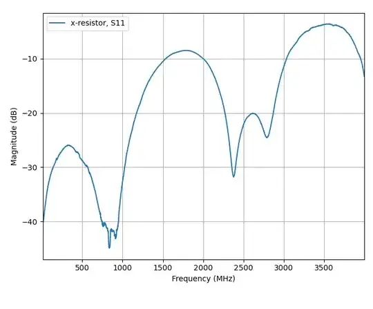

After I've received the board, I measured its S11 from 10 MHz to 4 GHz using a Vector Network Analyzer. It shows the return loss is good up to 1.2 GHz. But is it the full picture?
Measured S11 data

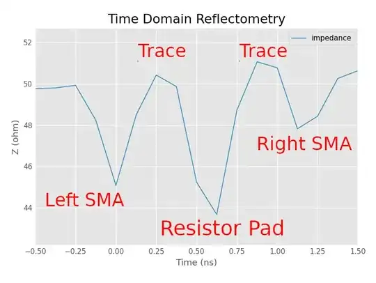

plt.figure() plt.title("Time Domain Reflectometry") network_dc.s11.plot_z_time_step(window='hamming', label="impedance") plt.xlim((-0.5, 1.5))
plt.tight_layout() plt.show()
TDR plot
This calculated TDR plot immediately reveals that the test fixture was poorly designed with non-ideal SMA-to-microstrip transitions. When the signal hits the first SMA connector, the instantaneous impedance drops to 45 ohms due to a capacitive discontinuity, then it hits the 50-ohm trace, hits the device-under-test, hits the 50-ohm trace again, and finally hits the second connector.
In fact, after de-embedding, it turned out that the resistor footprint only has 20 dB return loss at 800 MHz, not 1.2 GHz. The bad SMA connector footprints and the resistor footprint actually compensated each other. It would be difficult to spot this problem using the Smith Chart, on the other hand, it's obvious from the computed TDR response.

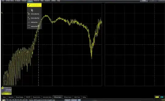

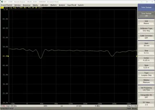

Alternatively, you can download Copper Mountain VNA control software (such as S2VNA) which can run in demo mode (without VNA connected). Software allows importing S1P data and postprocessing it with time domain / gating analysis free of charge.

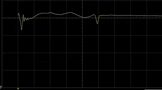

Here's an example of S11 data of a ~200mm long RG174 cable with SMA connectors on both ends, obtained with a 8.5 GHz Agilent E5071C when using Copper Mountain S2VNA Control software:
DCA
