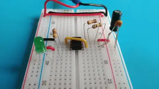

Minimal example
I have been facing different "surprising" behaviours with this circuit, and while trying to work my way out of this situation, I extracted the minimal example below:
This circuit is two 555 timers in astable mode mounted as separate sub-circuits on the same breadboard. (I call them separate because, as far as I can tell, they only share the power rails). The left timer should have a frequency ~1/10th right timer (thanks to the left discharge resistor being 100K, compared to 10K on the right)

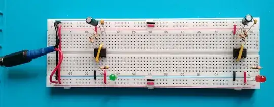

This behavior is what I observe if I only provide power to one timer at a time. But if I connect both at the same time (as shown in the picture above), then something I cannot explain happens:
- They both start flashing in sync, at a high frequency (but not exactly the second timer frequency, something a bit higher).
I cannot see how those two separate sub-circuits can talk... And from my understanding of experiment 17 in the book, they are not supposed to.

- I provide 9V via some universal transformer which provide quite stable voltage.
- The timers are marked
99AG7ZM NE555P - The ceramic capacitor in series with the control pin is 0.01μF (marked: 103), as recommended by the book.
- The electrolytic capacitor is 10μF 25V
- I tried replacing both timers with other timers (exact same model), resulting in exactly the same behavior.
- Initially, I built the two sub-circuits very close, and tried another build with more distance (as the pictures in the post).
Measures
Measuring the voltage across the electrolytic (timing) capacitor gives a value oscillating between ~3.1V and ~6V on each sub-circuit, which is exactly what is expected. It is true when only one sub-circuit is connected to the power bus.
Measuring the voltage of the same capacitor in the left subcircuit when BOTH timers are connected to the power bus gives a stable voltage ~3.27V (barely oscillating between 3.265 and 3.275). I cannot explain that either (yet I do suspect this is all the same problem).
