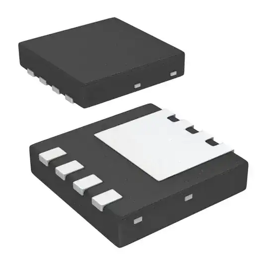

simulate this circuit – Schematic created using CircuitLab enter image description here FDMC4D9P20X8

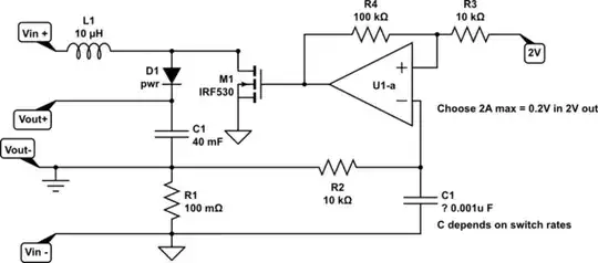

A better design can eliminate the surge and even make it CC, constant current by sensing return current and using a series L and shunt PWM and/or PFM switch to regulate the charge. Do that !
schematic
Perhaps something like this "quick and dirty design".
Tony Stewart EE75

  • @TonyStewartSunnyskyguyEE75 As I explained before, the only purpose of this circuit is to deal with stubborn "smart" BMS that easily allows up to 80A draw in normal operation but triggers short-circuit protection when battery is connected to the system for the first time, unless we limit the inrush to under 10A. This circuit does not have to protect or regulate anything. Any components capable of 80A constant draw will be huge. Also, there are no dual voltage sources at the time main switch is engaged. In fact, there is nothing but the battery and the switch to work with. – Maple Jan 09 '21 at 21:13

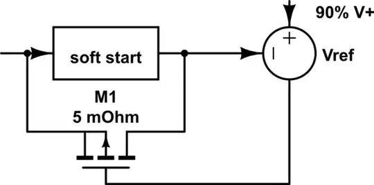

  • I understand. Any components? not true. 1mOhm FETs are small SMD's. Did you consider how this provides soft-start with any current you want by choosing RdsOn , L and diode? Then you decide what voltage you want to engage the relay to bypass the Vin+ to Vout+? why do you doubt? – Tony Stewart EE75 Jan 09 '21 at 22:09
  • @TonyStewartSunnyskyguyEE75 I meant inductor and diode. The FET you mentioned does not meet the requirement for 80A but following your suggestion I found several very interesting options, like TJ200F04M3L. Would you, please, explain what you mean by "min to max trip ratio" and where in datasheet can I find it? The good part of using P-FET based inrush limiter is that I would not need a fuse to protect resistor anymore. The bad part is that all examples I've found have same problem of time-setting capacitor not discharging quick enough when main switch triggered off and on again – Maple Jan 11 '21 at 06:17
  • These ratios determine the dynamic range which exceeds your spec.. you must choose the cap values for the time you need. That’s all. – Tony Stewart EE75 Jan 11 '21 at 13:18
