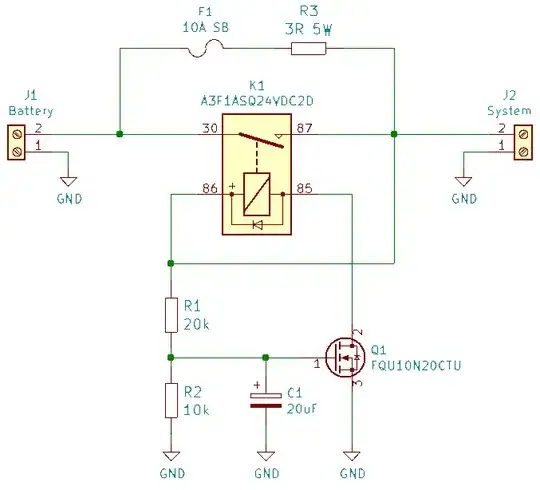

After reading all the comments we did some experiments. Any resistor 2.2R and up stops triggering of short-circuit protection. We also found some 75mA relays rated for 80A DC. While not ideal, still less dissipated heat than NTC. Below is the circuit I've come up with to delay relay activation for about 0.1s. Please, critique.
UPDATE 2
Assembled and tested the above schematics. Works as expected with R1, R2 increased to 47k and 22k respectively.

  • I've updated the question with proposed solution. Would appreciate any comments/suggestions on the improvement. One possibility is to separate C1, R2 with a diode, to prevent discharge voltage from going to the gate. Don't see any benefits in this, though. – Maple Sep 24 '20 at 17:14
