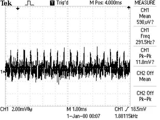

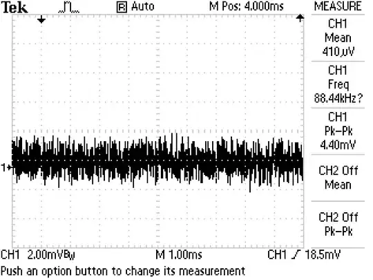

Anyway, the big problem is that I also get a 2kHz 10mV spike at the sensor. This creates noise that prevents from analyzing the sonar readings. The signal-to-noise ratio is not big enough.
sensor noise when motor off: enter image description here
sensor noise when motor on: enter image description here
