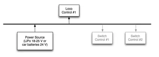

The idea is to build a simple garden railway control system. The garden at hand is a small one, remotely placed. The only source of power will be the batteries that I bring. The layout is also to be automated over time, but for locomotives will be manually controlled, likely via a radio link.
Figure: http://avendi.se/stackexchange/dpower-system-overview.png
The track will be used as a power bus: a LiPo battery or two car batteries in series will be connected to the rail to provide power to all rolling stock, and in the future, lamps, switches and so on.
Locomotives will be picking up power from the track, but will receive motor commands via radio. In the future, the locomotives will hopefully be fully automated.

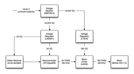

Each locomotive will be equipped with a small control circuit. The purpose is to both be able to drive the DC motor, as well as control the drive. The driver is centered around a H-bridge circuit (the L6202), and the control around an microcontroller (the ATmega328).
Figure: http://avendi.se/stackexchange/dpower-loco-control.png
As it is unknown how the locomotive has been placed on the track, a rectifier is first in line to give us a DC power line initially. This power is then fed into two different voltage regulators. One is to support the ATmega328 and whatever radio solution that will be chosen, and the other ons is to support the motor driver.

  1. The voltage regulator for the microcontroller (LM2937) will need to reduce the voltage from approx 20V DC to 5V DC. I am guessing most of it will be turned into heat. Is there any way to avoid this?
  2. The microcontroller won't draw much current, but the motor will, and I guess there might be noise and transients from starting and stopping the motor. Do I need to protect the microcontroller (or its voltage regulator) from this? If so, how?
  3. How can I protect a LiPo from short-circuits or other problems? I don't want any LiPo fires.

  1. Use a buck converter to avoid the power loss when dropping the voltage down. Dimension Engineering has some good modules, and an excellent introduction here.
  2. It depends on your specific regulator, but the easiest thing to do is to put some capacitors on both the motor power supply and the sensitive electronics rails.
  3. A fuse is the easiest method of protection, but requires that you replace it every time the rails are shorted. A DC breaker will protect your batteries and is resettable after a short.

I wouldn't worry about losses from the microcontroller's voltage regulator. Yes, most of the energy goes into making heat. But, the current needed by the microcontroller will be so small compared to the motors that it's probably not worth concern. For more detail on how to calculate just how much heat there will be, see My linear voltage regulator is overheating very fast.
I would suggest dropping the voltage regulator for the motors. A PWM-driven motor is already a buck converter, so as long as you aren't exceeding the maximum voltage of the driver, you are probably safe. The voltage rating for motors is usually the maximum continuous voltage they can take, but peak voltage is much higher, limited basically only by the insulation in the windings. As long as your motor controller is doing its job of limiting the current, and thus the power and heat, to the motor, a higher voltage motor drive is fine. Adding a regulator to the system just makes it more inefficient.
The motor will generate noise. Reduce it by including plenty of bypass capacitors, from small ones around each IC, to big ones to supply the motor. Also, arrange your PCB and cables to minimize the area of the loop through which the motor current travels. This will minimize the inductance of that loop, and thus reduce its inductive coupling to everything else in your circuit. Remember that the motor current flows not only through the positive supply but also ground. Keep these currents away from the microcontroller's ground. Your motor is small enough that you should not require any extraordinary measures beyond good layout and standard practice to keep noise at reasonable levels. I have a previous answer on noise with some more detail. Also, a linear regulator usually has better power supply noise rejection than a buck converter: another reason to retain the 5V regulator.

  • Thanks for you answer! A follow-up question: In the case where the loco is idle, and the only thing consuming power on the track is the loco, will the microcontroller voltage regulator hold up? – David Pettersson Jul 24 '13 at 07:32
  • I don't see why it wouldn't. – pjc50 Jul 24 '13 at 07:59
  • According to the linked article on voltage regulators, I am in a similar situation. I have a voltage drop of 19V, and a current draw of about 200 mA. The LM2937 is a linear regulator. Should I exchange it for a switched one? – David Pettersson Jul 24 '13 at 08:18
  • Use a switched regulator if you have the space, certainly. I was assuming the draw would be more like 1ma for the microcontroller, and had forgotten to count the radio reciever. – pjc50 Jul 24 '13 at 09:06
