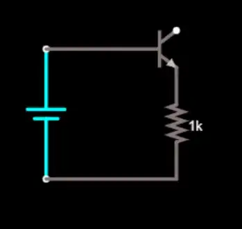

Suppose when the collector is connected we get \$I_b=10 mA\$, and \$I_c=1000mA\$, so naturally we have \$I_E=1010mA\$.
What will happen when the collector is disconnected? Will the base current change from 10 to 1010mA? In other words, can we say the emitter current is solely determined by the base configuration? In this case it is V_BB-0.7/1K (assuming the transistor is not operating in the breakdown region).

    In this case, what you have is IB = IE and an "ordinary" diode voltage drop between base and emitter. – G36 Dec 20 '20 at 17:56
    So when I connect the collector just this current base current would reduce , and the collector would draw the excess current right? – Sayan Dec 20 '20 at 17:59

The emitter current is (Vbase - 0.7)/1k with or without the collector connected to a positive supply voltage (assuming the battery has zero internal resistance).
With the collector connected, this emitter current will be split in the ratio of hFE (beta) between the base and collector.
Now disconnect the collector supply and the emitter current doesn't change (assuming an ideal battery which has zero output resistance) but now all the emitter current is pulled from the battery through the base. There is no collector current and the emitter current has remained unchanged throughout.
    There will be some difference in the voltage drop across the base-emitter junction because the current through the junction is quite different in the two cases. So there will be some difference in the emitter current. – Circuit fantasist Dec 20 '20 at 23:24

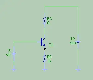

To complement James' answer, it might be helpful to approach the open collector condition by gradually increasing a collector resistance connected to a positive power supply.
Here I have used a reasonably small Vb and an initial value for Rc that won't cause the transistor to fall into saturation. With these values, we set the emitter current via Re to the (approximate but reasonable accurate) value of (5-0.7)/1k = 4.3 mA, which will give a nearly equal collector current through Rc. Voltage drop across Rc=8 ohms will be a handful of mV and Vce will be nearly 7.7V. The transistor is in active zone and hFE is the full value 200, so Ib needs to be only 20 uA. Basically, all the emitter current is due to the collector current.
When we increase Rc, the transistor will do its job to keep the current in Rc almost constant as long as it stays out of saturation. But we cannot force 4.3 mA forever into increasing values of Rc. At one point the voltage drop caused by Rc*4.3mA will exceed the supply voltage minus the voltage drop across Re. The transistor cannot drop Vce under zero volts - actually it will reach 0.1V or so, so the maximum value of Rc for which we can pull the current 'programmed' via Ie is about (12V-4.3V)/4.3mA = 1.8 kohm (rough estimate).
After that, we will assist to the demise of the transistor action, and the reinstatement of Ohm's law in all its glory.

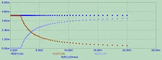

Increasing Rc will decrease Ic as in (Vcc-fixed value)/Rc, and we can see this trend in the following graph
The decrease in the ratio Ic/Ib is reflected by the forced hFE that characterize saturation.
Since Ie is roughly set by the BE mesh, the decrease in Ic will be associated with a corresponding increase in Ib. In the limit for Rc->infinity, all the emitter current will have to be supplied by the base.

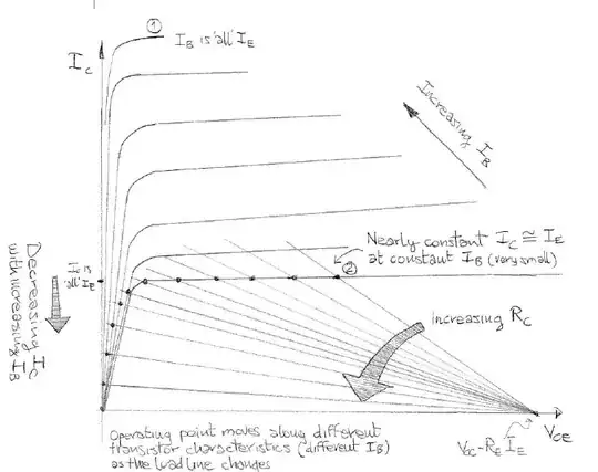

We can try to visualize how this plays out on the output V-I characteristic of the transistor if we acknowledge the fact that being Ie constant, the term Re*Ie is also constant and we can subtract it from the expression of the load line. As Rc varies we will see this set of curves
VI chars and quasi-load line
where the operating point, intersection of the output characteristic with the increasingly tilted load line, is seen moving from the active region into to the saturation region, down to the point where Ic = 0 and all Ie is contributed by Ib. Notice that we are crossing characteristics here: we do not stay on the same Vce-Ic curve for a fixed Ib as would happen with a common emitter configuration with base limiting resistor, but as Ib increases, we move to different characteristic curves.

    @Circuitfantasist no problem, but all I see is the correction of a letter. Maybe later I will add a picture showing how the operating point slides down the knee into saturation as Rc increases. – Sredni Vashtar Dec 21 '20 at 09:45

    When you extend the simulation range up to app. Rc=200k the collector current will drop down to app. 20µA. That means: Ib=Ie with good accuracy. – LvW Dec 21 '20 at 10:39

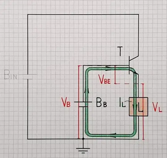

So, the OP's question is about an emitter follower considered in two situations - without supply voltage ("damaged") and with supply voltage ("restored"). Considering them one by one, we can explain the meaning of this circuit when used as a buffer.
I will use two figures from the link above to illustrate my explanations. There the invisible electrical quantities are visualized as follows. Voltages are represented by vertical segments (voltage bars) with proportional height in red. They are summed (subtracted) geometrically, according to KVL (this clearly shows the relationship between voltages). Thus the set of voltage bars on the circuit diagram can be considered as a snapshot of the voltage relief. Current paths are shown by closed lines (current loops) starting from the positive terminal of the power supply and ending at its negative terminal. Current magnitudes are hinted by the line thickness.
"Damaged" emitter follower
If there is no supply voltage (the collector is unconnected), there is no emitter follower since the transistor is not a transistor but rather a diode - Fig. 1. Only its base-emitter junction is used as such a "diode"... and the input voltage VB is transferred directly through it to the load in the emitter (the 1 k resistor in the OP's picture).
Battery supply
Fig. 1. An emitter follower without supply voltage
Since the battery supplies the load through the base-emitter junction the whole load current IL flows through the junction. As though the input voltage source is directly connected to the load (only a small voltage drop VBE is subtracted from the input voltage). Usually, this is not a desired situation since the load can be too heavy for the input voltage source and can overload it.

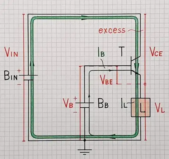

"Restored" emitter follower
So let's restore the supply voltage (connect the collector) - Fig. 2.
Battery backup supply
Fig. 2. An emitter follower with supply voltage
The transistor "becomes a transistor" and begins acting as a device with negative feedback... or as a "being" implementing some goal. "Seeing" the significant base-emitter voltage, it begins increasing its collector current (IL) so the voltage drop across the load (VL = IL.RL) increases. Since the base-emitter voltage is a difference between the constant input voltage VB and the increasing output voltage VL, it begins decreasing (VBE = VB - VL)... and finally the equilibrium is reached by the negative feedback. VL will be (slightly) higher than in the case of the "damaged" follower; so the load current (IL = VL/RL) will be slightly higher as well.
Now let's look at the situation from another perspective. The transistor passes its collector current through the load in parallel to the base current thus "helping" it. The input battery provides only the small base current needed to set the beta times higher collector current and, accordingly, the load current needed. As though, the battery tries to supply the load by injecting the small base current through the base-emitter junction to the load... and the power supply, by the help of the transistor, "helps" it by adding beta times bigger collector current. Figuratively speaking, you can think of the collector-emitter part as a "big brother" that helps the "little brother" (base-emitter junction:) This metaphor can help to intuitively understand the main idea behind the emitter follower used as a buffer.
