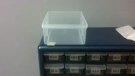

Oh and as a side note, if anyone has a good schema for keeping resistors quickly accessible I would love to hear it!

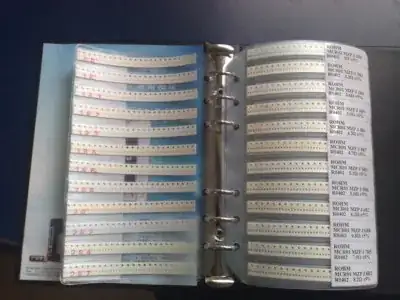

[This is more of a comment. I'm posting this as an answer, because I'd like to add a picture.]
Storing SMT resistors and capacitors in a binder provides the quickest access. I've tried several methods for storing SMT component kits, until I started to use binders.
