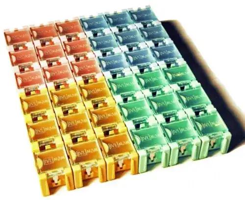

You can find SMT parts storage bins on eBay, like this:
They can be opened with tweezers and closed very easily. I typically have a few "trays" of them, where one is for capacitors, one is for resistors, etc.

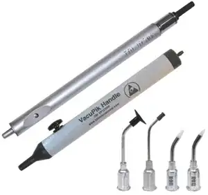

As for the tools you can use a vacuum pickup tool. They come either as a hand operated pump (small button you press/depress to operate) or with external vacuum pump. They have various tips to fit the component.

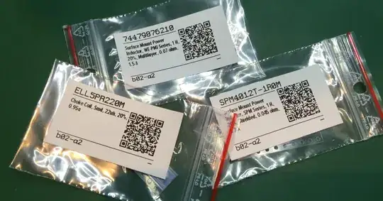

I found that the various storage bins/drawers for SMT/SMD components aren't really practical. Sure, they look nice, but it's way too much work to put components in, and then take them out. When hand-assembling, I take components directly from tape strips, trays, bags or whatever they come in, and place them onto PCBs.
I work with only one component at a time, so I rarely have a problem of telling which part is which.
As for storage and retrieval, I mostly use small zip-loc bags with printed labels. These go into my storage boxes. I use PartsBox (https://partsbox.io/) to keep track of everything I have (disclaimer: I am the founder of PartsBox).
Components on cut tape in their zip-loc bags (the bags are 7x5cm):
Parts in ziplock bags
And this is how a typical storage box looks like (when searching for a part, PartsBox will point me to a specific drawer, like b01-c1):
Storage boxes
If anyone is interested in more details, I also wrote a more extensive article about how I store electronic parts: https://partsbox.io/blog/how-to-organize-electronic-parts-04-2017.html
