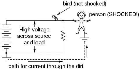

The writer explained why the bird is not shocked while the man got shocked:
This might lend one to believe that its impossible to be shocked by electricity by only touching a single wire. Like the birds, if we're sure to touch only one wire at a time, we'll be safe, right? Unfortunately, this is not correct. Unlike birds, people are usually standing on the ground when they contact a "live" wire. Many times, one side of a power system will be intentionally connected to earth ground, and so the person touching a single wire is actually making contact between two points in the circuit (the wire and earth ground):
While I know that current flows from the negative end to the positive end, I had a concept ( which is probably wrong ) that after passing through the load, the energy would be consumed and therefore it is safe for anybody to tough the positive side of the wire.
On the other hand, the writer said the bird is not shocked because the bird didn't complete the circuit if the bird only put 1 foot on the wire. And even though if the bird put both legs on the wire, a circuit for the current was completed, the 2 legs were electrically common so there is no voltage across them. I think the man in the picture are in similar situation but he was shocked. How come? Does the present of the load make a difference? What if the load is removed, and the man grabs both the negative end and positive end of the powered wire?

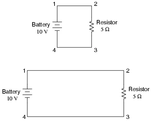

I read the chapter again. According to it:
If connecting wire resistance is very little or none, we can regard the connected points in a circuit as being electrically common. That is, points 1 and 2 in the above circuits may be physically joined close together or far apart, and it doesn't matter for any voltage or resistance measurements relative to those points. The same goes for points 3 and 4. It is as if the ends of the resistor were attached directly across the terminals of the battery, so far as our Ohm's Law calculations and voltage measurements are concerned. This is useful to know, because it means you can re-draw a circuit diagram or re-wire a circuit, shortening or lengthening the wires as desired without appreciably impacting the circuit's function. All that matters is that the components attach to each other in the same sequence.
The whole theory of electrically common is based on the fact that the wire got very little or none Resistance so that it require almost no voltage to push the current from point 2 to point 1. However, if we consider the bird is on its 2 legs, it would form another path for the current and the resistance is somehow much larger than the wire. I think it is the Resistance of the bird itself matters. Am I right?

The man gets shocked because his hand is touching the positive terminal, and his legs are touching the ground, which is connected to the negative terminal. Since the positive terminal is at a high potential relative to the ground, he gets a shock. If the load is removed, he still gets a shock.
The bird doesn't because it's only touching the positive terminal, so there is no potential difference across it's body.
Remember voltage is always between two points. You can't just say "this point is at 5V", you have to say "this point is at 5V relative to this point" (although people often say the former because a common reference point, like circuit ground is assumed)
Regarding the energy being consumed part, as long as the voltage source is strong enough (i.e. has a low internal resistance) an assuming it has "infinite" capacity to keep supplying power (e.g. a mains source as opposed to a battery or capacitor) then it will supply current to many loads connected in parallel to it, without it's voltage dropping appreciably.
If it is a weak source, then it's voltage will drop if a low resistance load is connected across it - in this scenario it would be safe(r) for the man to touch it (depending on how much the voltage drops - this sort of stuff is all covered by Ohm's law, Norton and Thevenin)
Regarding edit
In an ideal situation where we assume the wires have zero resistance, then the resistance of the bird does not matter. You are right that the resistance of the bird could matter in the real world though.

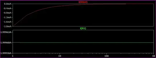

We can take a look at this with a SPICE simulation. We will use your circuit above, and assume the resistance of the wire between the birds legs is 1mΩ. By varying the resistance of the bird we can see what would be needed to cause an appreciable current to flow through it:

Simulation, seeping the birds resistance from 1Ω to 1kΩ:
Bird Shock Circuit Simulation
You can see the current through the load R1 (green trace in the bottom graph) is around 2A, and hardly changes at all.
For the bird, even with a resistance of only 1Ω, it only has 2mA flowing through it. At 1kΩ, it has 2μA flowing through it (note the logarithmic graph used on the X axis due to the large variation)
In reality, unless the bird is soaking wet, and the cable it's standing on is very thin, then the above values are a long way from typical. Typical bird resistance will probably be > 1MΩ, and the resistance between it's legs probably less than a few μΩ.
Hopefully this makes some sense - it all agrees with Ohm's law, and once you get the hang of it it will seem quite natural. It might be good idea to grab something like LTSpice (the simulator used in the above examples and have a play around with it to see what happens when you change various things. Or build a circuit on a breadboard and measure with a multimeter. Also, have a good book that covers this stuff handy (see "Art of Electronics", "Practical Electronics for Inventors", etc)

You only get shocked when current passes through your body. The bird doesn't get shocked since the bird is only touching one wire and it isn’t touching the ground either. Because of this, the current doesn't have anywhere to go since there is no potential difference (voltage) between 2 points since the bird is only touching one "point" (1 wire), and like I mentioned earlier, isn’t grounded. The human gets shocked because they are touching 2 points that have a potential difference (voltage) between them, which results in current flow. The live wire has a higher potential than the ground.
For example, in the US, live wires are 120 volts, and the ground (wire) is always 0 volts. If you touched both the ground and live at the same time, it would result in a potential difference of 120, allowing for current to flow. Voltage is the cause and current flow is the effect. You need voltage in order to have current flow.
Archan6el
  • Welllll...if the bird puts both feet on the same wire there will be a voltage difference between the two feet and some current will flow through the bird as a result. But, the voltage difference is very small and the resistance of the bird is very high compared to the resistance of the short section of wire, so a very, very small current will flow through the bird. Not enough to get the bird's attention, but not strictly zero either. – Elliot Alderson Feb 27 '21 at 19:55
  • @ElliotAlderson Yeah, good catch. I just didn't mention that because I wanted to keep it simple, but you are totally right. – Archan6el Feb 28 '21 at 19:15
