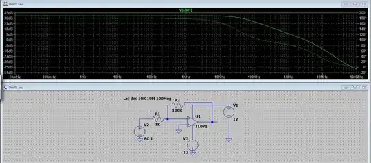

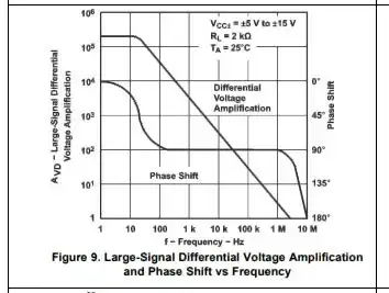

I'm experimenting with op-amps and ceramic filters at 455 kHz. I chose TL071 because it was readily available and the datasheet specified a slew rate of 13 V/μs and a GBW of 3 MHz. But in the datasheet it shows that the large signal differential gain drops dramatically after 100 Hz.
My Ltspice simulation also shows similar effect.
My question is can I use this device for making a 455 kHz signal amplifier in practice as the simulation shows about 18 dB gain at 400 kHz?

My question is can I use this device for making a 455 kHz signal amplifier in practice as the simulation shows about 18dB gain at 400KHz?
The 18 dB of gain you get roughly tallies with the open loop response from the data sheet so, you can amplify the 455 kHz signal but if you are expecting a clean distortion free output it might not be quite like that because the op-amp is running pretty close to to its top-end of the spectrum and op-amps rely on a lot of "spare" open-loop gain for a "high fidelity" signal amplification.
