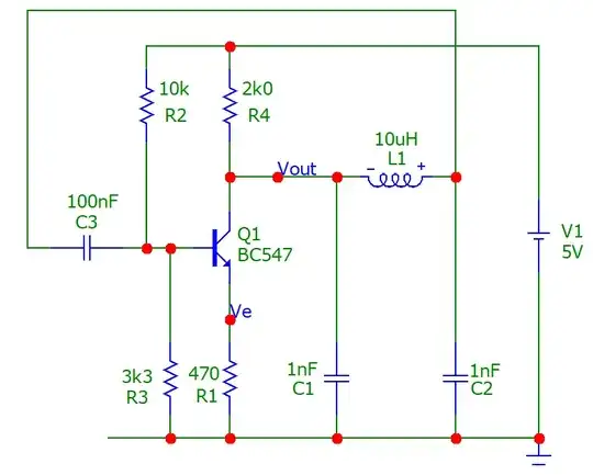

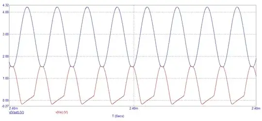

Exactly the same methods. Consider this common-emitter Colpitts Oscillator: -

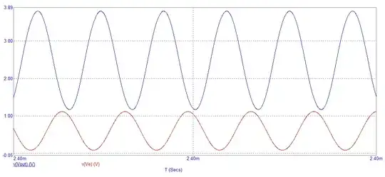

Transient response showing clear signs of too much loop-gain hence distortion: -

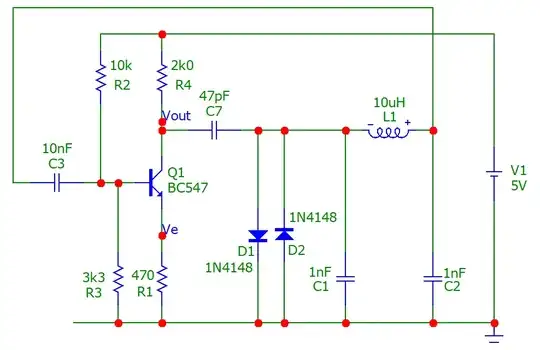

Then consider this modified Colpitts Oscillator with diode clamps: -
Transient response showing very little distortion: -

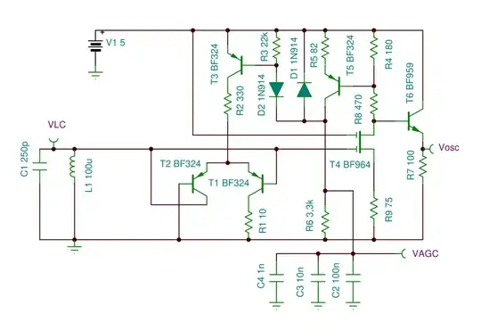

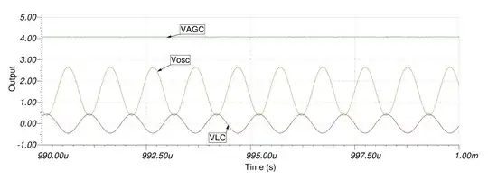

An emitter coupled oscillator with AGC circuit. The rectified signal controls the emitter current of the oscillator. The voltage at the LC points is small (<+ - 0.5V) regardless of the frequency, very favorable for possibly varicap tuning. The circuit is based on an old ECL oscillator (MC100EL1648). oszc1
oszc2

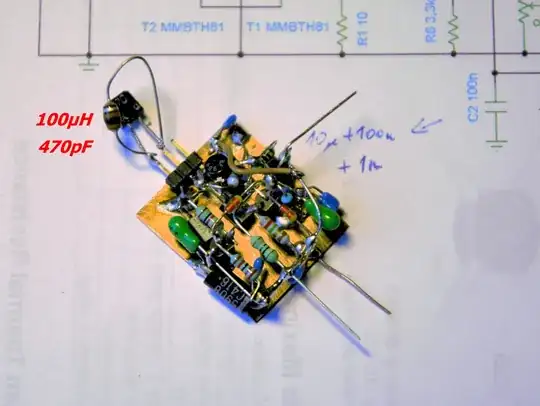

A test piece: oszcpróba

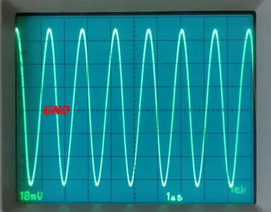

VLC signal: oszcszkóp
The oscillator operates between a few kHz and hundreds of MHz. Only the LC values ​​need to be changed.

  • May I ask whether it is possible to substitute the dual gate mosfet with a bjt? Cold you provide that version? – User Sep 10 '20 at 03:50
  • Yes it can be. On the other hand, only a PNP transistor can be considered, since the signal on the resonant circuit is symmetrical to zero (+ - 400mV). After the PNP emitter follower, another amplifier stage is needed for the larger output signal. The advantage of a dual gate MOSFET is the lower input capacity (higher operating frequency), the disadvantage is that the DC op. point must be set individually (R9, 100 Ohm trimmer). You can also use the factory circuit, but there the output signal is rectangular. Only input (LC) is sine vawe. – csabahu Sep 10 '20 at 07:58
  • I imagine you suggested a PNP device because the capacitor can be grounded for decreased hand capacitance effects. Also why is the output of factory circuit rectangular? – User Sep 10 '20 at 09:08
  • PNP is needed because an NPN cannot handle the negative input signal without a negative power supply. What can do this is JFET, D.G. MOSFET and PNP transistor. Unfortunately, I don’t know what the factory ECL oscillator was used for. The normal output signal is a 0.7V amplitude rectangle. – csabahu Sep 10 '20 at 10:54
  • But I have simulated basic NPN version of this without any AGC in LTSpice with +ve supply. Here is the link. https://imgur.com/IEhl4SM ; https://imgur.com/QYPyH8G – User Sep 10 '20 at 15:56
  • Increase the value of R1 so that the sine is not distorted. A different L / C value will have a different R1 to eliminate the distortion. Change any of them and you will see that each will need a different R1. – csabahu Sep 10 '20 at 16:53
