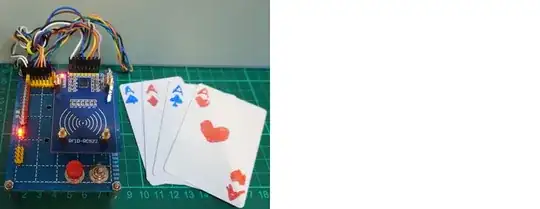

Question
Can a RFID reader read a stack of playing cards?
rfid test 1
Answer
Short Answer
(1) My RFID reader will freeze if given a two card stack to read, and
(2) It will complain if I try to slowly splay the two cards.
Long Answer (TLDR)
Part 1 - Introduction
The RFID reader can of course read cards one by one, but not sure what will happen if trying to read a stack or a splay.
I have a python program to read cards one by one, next step is try to read a stack.

(1) Which kind of RFID reader and library to use for testing
I have basically two kinds of cheap RFID modules, pn532 and RC522. I can use SPI, I2C or UART interface, using libraries or writing a program using python. However, I think there is no need to spend time to choose which reader and which library to use, because I think they are not relevant. Also I think the reading distance is also not relevant, my two kinds of RC522, and THM3060 can read cards at 2 cm and 10 cm. But I don't think distance matters.
So I think what to find out first is the following:
If I give a stack of cards for the RFID card reader to read, will it just read the card that it get the strongest signal, or the first card that he gets a signal, or random?
(2) Testing procedure
(a) Take 4 cards and separately write the names Spade Ace, Diamond Ace, Club Ace, and Heart Ace to each of them and then read back.
(b) Now try to read them again, but two cards at a time, three at a time and four at a time.
Part 3 - Testing Results
So I first tested 4 playing cards one by one, giving them names "Heart Ace" etc. Then I read them back one by one without any problem.
Next is the fun part. I give a two card stack, but the reader hangs. I think it gets confused of a corrupted signal.
Next I tried to splay them, very very slowly, as I was playing poker. Then a weird thing happens, the reader gave the following error message:
AUTH ERROR!!
AUTH ERROR(status2reg & 0x08) != 0
What is also interesting is that the Thonny python 3.7.3 prints the above message
IN BRIGHT RED!!! (This is my first time seeing a red warning from Thonny, after programming Thonny python for a year or so!)

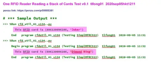

And this is a sample output
Sample Output
%Run rfd_util_01_v134..py
 Begin program rfdutil_01_v134 (Testing SimplMFRC522)  tlfong01  2020-09-05 16:17
   spiPortName   = SpiPort00
   spiSpeedName  = 1 MHz
   This RFID card is (647176253282, 'Diamond Ace                                     ')
 End   program rfdutil_01_v134 (Testing SimplMFRC522)  tlfong01  2020-09-05 16:17
%Run rfd_util_01_v134..py Begin program rfdutil_01_v134 (Testing SimplMFRC522) tlfong01 2020-09-05 16:18 spiPortName = SpiPort00 spiSpeedName = 1 MHz
AUTH ERROR!! AUTH ERROR(status2reg & 0x08) != 0
/ to continue, ...
/ to continue, ...

Sample Output
Python 3.7.3 (/usr/bin/python3) %Run rfd_util_01_v134..py Begin program rfdutil_01_v134 (Testing SimplMFRC522) tlfong01 2020-09-05 16:08 spiPortName = SpiPort00 spiSpeedName = 1 MHz
   This RFID card is (504284031262, 'Dimond Ace                                      ')
End program rfdutil_01_v134 (Testing SimplMFRC522) tlfong01 2020-09-05 16:08
