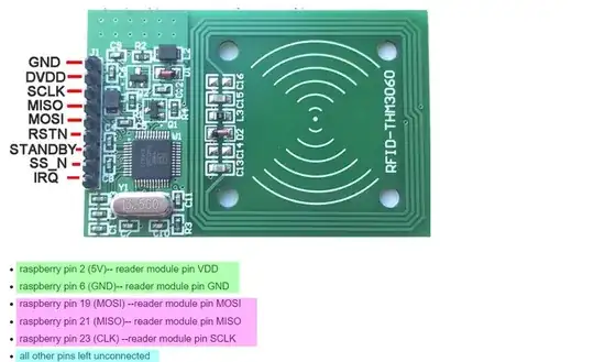

I got the following rfid reader from a colleague enter image description here
https://www.aliexpress.com/item/4000035966273.html?spm=a2g0o.productlist.0.0.4ac14adcZL3H9M&algo_pvid=af835e25-e532-4426-8714-cd80a9871169&algo_expid=af835e25-e532-4426-8714-cd80a9871169-0&btsid=0ab6d70515978825018782158e600d&ws_ab_test=searchweb0_0,searchweb201602_,searchweb201603_
I have connected it to my raspberry pi 4 module b using the following pinoutenter image description here;
  • raspberry pin 2 (5V)-- reader module pin VDD
  • raspberry pin 6 (GND)-- reader module pin GND
  • raspberry pin 19 (MOSI) --reader module pin MOSI
  • raspberry pin 21 (MISO)-- reader module pin MISO
  • raspberry pin 23 (CLK) --reader module pin SCLK
  • all other pins left unconnected

My problem is that the reader is not reading data. I confirmed that the system does power up using an LED and (a resistor) in series connected to the VDD. The reader was pulling 0.46mA using a 3.3V supply, and 0.74mA using a 5V supply (measured using a multimeter).
When I fire up the raspberry and run the code, the reader does not seem to be reading any data from the rfid chips I have. I did confirm that the chips contain data using an other reader module.
I did go through the documentation but I havent found anything useful.
http://read.pudn.com/downloads567/ebook/2333609/THM3060_UM.pdf?fbclid=IwAR1y0qh-cUdnnL9wfk-ZVLEcNVTvyHoviiM6Qsg6VQggS1zu8OVPTPRnPrU
I tried connecting pins RSTN and STDBY to ground but it made no difference. I have no contact with the seller unfortunately(wasnt the one who made the order), so i cant get any more information about the reader. Has anyone had any luck with these specific types of readers? How else could I trouble shoot the system? Continuity tests have confirmed that there are no damaged traces on the reader board itself.
How can I get it to read/write data?

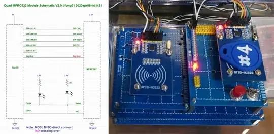

The OP's RFID module wiring is show below.
rfid 1

Part A - Schematic

Part A - Schematic
Introduction

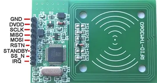

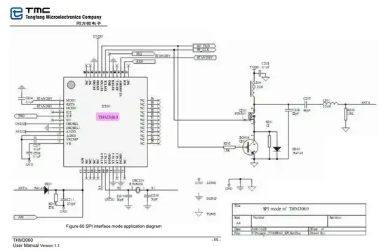

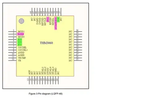

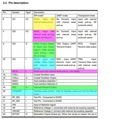

The AliExpress product sheet says the OP's RFID module is RC522 based, but the user guide only mentions THM3060, nothing about RC522. So I need to study carefully if the two chips are 100% compatible, and if standard RC555 wiring is used. Therefore I need to read the schematic very carefully, to find any incompatibility.
rfid module schematic
thm3060 pinout
thm3060 pin function

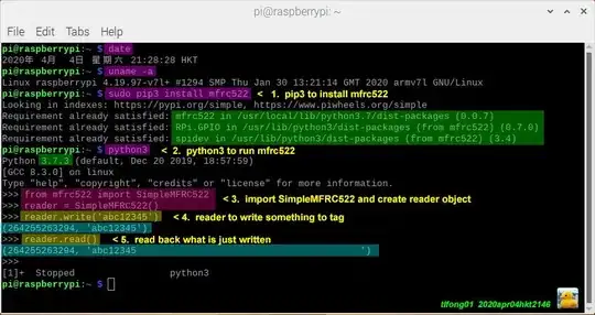

Part C - Pi My Life Up Library Testing Notes
Introduction
The OP says that he is following the Pi My Life Up tutorial. So I search my old files to find a similar test I did for his reference. It is not clear if he has already done the basic test of SPI loop. So I also include the loopback test, as shown below. The details is described in Ref 4.
Setting Up
rfid 3

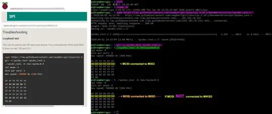

SPI Loopback Test
rfid 4

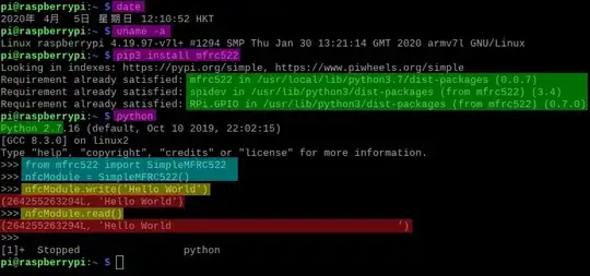

RC522 Pi My Life Up Test using CLI Commands
rfid 5
RC522 Pi My Life Up Library Test Using Python
rfid 6

  • Ah, thank you for your reply. Now 4 quick suggestions. (1) Read Part C of my answer and do the CLI SPI loopback test. It is important to first make sure the SPI wiring is OK, (2) Then again use CLI to test SimpleMFRC522. If you have difficulty using CLI commands, I can try to find old python to test in Thonny IDE. (3) I would suggest to power your RIFD moudle with 3V3, that is what I did last time. (4) I was playing with both RC522 and PN532, using UART, SPI, and I2C at the same time, and I forgot which module is using which, so I might have mixed up things. So compare my screen captures. – tlfong01 Aug 20 '20 at 07:39
    What do i connect the SPI CS0 pin to on my board? I dont seem to have any more SPI related pins (as shown on the second image) – Malcommand Aug 20 '20 at 07:53
  • Ah, thank you for clarification and confirmation on the 5V power supply. So I quickly conclude the the user guide V1.1 (which says 3V3 ~ 3V6 is optimum) or something is out of date, because they have V1.2 or V1.3 (Note 1), I forgot. Just now I looked at my RC522 module and did not find any 3 pin 5V to 3V3 regulator, so I always use 3V3 for testing. As the old smart guy Warren Buffett says: There "aren't just one cockroach in the kitchen“. So should expect more misinformation. Already mentioned that their chip is NOT 522 but might not be 100% compatible chip. – tlfong01 Aug 20 '20 at 07:58
  • About the CS pin, because they are using the same board with UART, I2C and SPI, so they are using one or two pins for more than one function. Let me check and report back. – tlfong01 Aug 20 '20 at 08:00
    Also, is the SPI loopback test conducted with the reader connected to the raspberry, or is it only connecting the MISO pin of the raspberry to the MOSI pin of the raspberry directly? – Malcommand Aug 20 '20 at 08:04
  • You might like to look at my photo above. My SPI colour coding is this: CLK = purple, MOSI = orange, MISO = yellow (some time might be swapped). But CS0 should be GREEN in the picture (sometimes I also use blue, brown, grey etc for more CSn, but green is 99% sure the CS pin.) I remember there are two versions of RS522 boards, so you need to look at the labeling at the reverse time of the PCB. – tlfong01 Aug 20 '20 at 08:06
  • Ah, yes, when testing SPI loopback, you put the RFID module aside and just test this loopback thing. Procedure (1) connect/short MOSI to MISO, then do the test. (2) There is a slight complication. SPI loopback only makes sure MOSI writing out can be read back by MISO, *** CS pin is NOT tested.***. So you need to use a python program to read the module's register (sort of pinging) to make sure CS0 is also working. Another thing is that you should not use wiring of longer than 30~60cm, the shorter the better, – tlfong01 Aug 20 '20 at 08:11
  • Also you might like to lower SPI speed to 100k, 50k or even 10kHz, just for testing. – tlfong01 Aug 20 '20 at 08:12

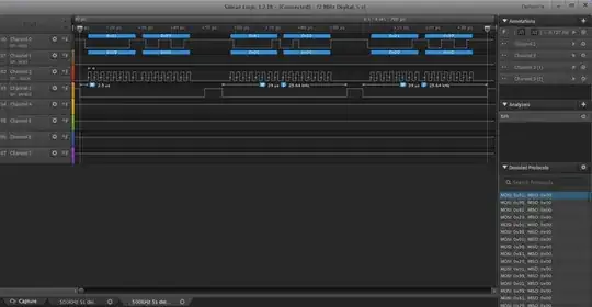

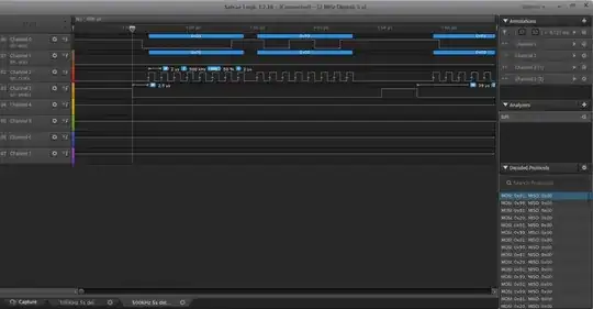

Following a long and rigorous troubleshooting process I have come to the conclusion that the device must have hardware issues. Possible design related integrity problems or issues within the microchip itself.
I was able to test the signals with a logic analyser and it can be clearly seen on the attachments that no response is received on the MISO line.enter image description here The image above shows a read-write-read sequence for register PSEL. It was not possible to obtain any MISO values.I have tried multiple clock frequencies but nothing made a difference (all of them were well within the maximum 2.5 MHz range).
Sadly I dont have a scope so I cant check signal integrity. But Im confident that the issue is with the hardware itself
