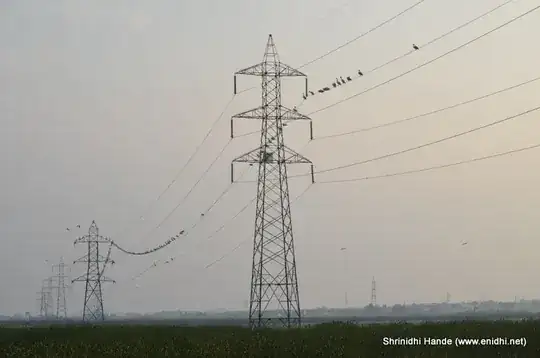

Doesn't seem to bother these little guys....

  • Apparently it does on extremely high voltage lines. They get zapped before the even land so I'm told. – DKNguyen Sep 03 '20 at 16:30
  • Maybe - I'm not a bird expert. But those are some very high voltage lines they're sitting on above. What do you mean by "extremely high voltage"??? – Kyle B Sep 03 '20 at 16:30
  • 200kV https://electronics.stackexchange.com/a/430867/212967
    – DKNguyen Sep 03 '20 at 16:31
  • Paul Harrow's response: https://www.quora.com/Why-dont-birds-sit-on-high-voltage-power-lines – DKNguyen Sep 03 '20 at 16:34
    Paul Harrow response makes sense. They're not getting electrocuted, but they get 'zapped' from coronal discharge. I could see that being painful LOL https://en.wikipedia.org/wiki/Corona_discharge#:~:text=A%20corona%20discharge%20is%20an,conductor%20carrying%20a%20high%20voltage. – Kyle B Sep 03 '20 at 17:07
  • @KyleB: i see what you mean, but "electrocuted" means death at the hands of electricity, no matter the operation. – dandavis Sep 03 '20 at 20:44
    Right. So I guess then the answer to your original question "Can you get shocked if you touch a hot wire whilst perfectly electrically insulated?" is yes. But not due to capacitive coupling to the ground, but rather through coronal discharge to the surrounding air. The suits that linemen wear (and this is pure conjecture) may not be acting as a Faraday cage, rather they are designed with no sharp protrusions that would induce a coronal discharge. – Kyle B Sep 03 '20 at 20:55
  • If you check out the youtbube video in my answer, there is some Q and A under the video. The video author says that birds never land on energized transmission lines. He said they can feel some effect from the strong electric field around the wire and veer off. It seems that he is a lineman, so I am inclined to believe and agree with DKNguyen. It is possible that the lines in this picture are not energized. – user57037 Sep 09 '20 at 02:40
