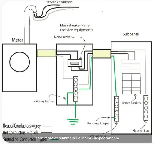

If there is no return path you will not be exposed. But there is a return path: the ground wiring in your home is tied to earth through a pad or rod, and to neutral at the panel. This means that the ground under your feet is electrically connected to the neutral wire leading back to the voltage source (e.g. your neighbourhood "step down" transformer)
See the picture below which shows that connection in the panel. (Ignore the subpanel/panel split, the point is that it shows the neutral bonded to the ground at the panel.)

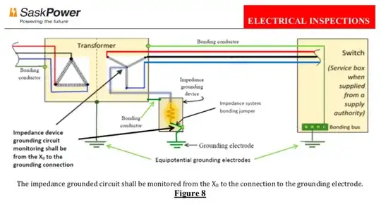

The diagram in your question incorrectly annotates the neutral to ground voltage as 0V. The "stabilization" shown (as 0V) requires a high-ohmic or low-ohmic grounding to neutralize the potential.
A high-ohmic earthing is used to stabilize the potential while avoiding a dangerous ground loop. A low-ohmic earthing is used to protect metal housings or exposed metal parts if a short from live to metal should occur, thus tripping a ground fault interrupter or a over-current breaker before a fire is started or a user is imperilled.
As drawn, there is no earthing, and that voltage to earth is an unknown.
Here is an example of an impedance grounding on the secondary side: (it's for a 3-phase system, but the principle is the same)

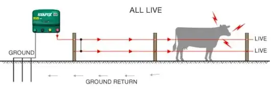

Livestock electrical fences work on this principle: they provide a high voltage spike to overcome a (high resistive) path through earth.
(Image from https://www.stafix.com/en-us/helpful-information/grounding-your-energizer )

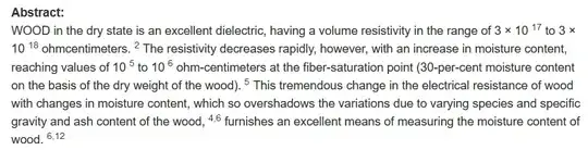

For example, the resistance of rubber is on the order of \$10^{13}\$ Ohms-meters. This should be quite a bit higher than most materials. The resistance of copper is on the order of \$10^{-8}\$ Ohm-meters. So that's a difference of \$10^{11}\$ times. We would need an area of rubber \$10^{11}\$ larger than the area of the copper for it to be equally conductive.
The area for 16AWG wire running to your toaster is \$1.31mm^2\$. The area of your feet is about \$0.09m^2 = 8100mm^2\$ That's on the order of \$10^{3}\$ times more area. So your feet have a lot more area than the wire but but nowhere near \$10^{11}\$, right?
But let's try and guess the area of your entire floor or the cross section of your building. Let's just pick something small, say \$10m \times 10m\$ = \$100,000,000mm^{2}\$ That's \$10^{7}\$ times more area. Getting closer to \$10^{11}\$.
But now consider that you will get hurt by a lot less current than something like a toaster will. Just a few mA is enough. That 16AWG wire was sized to carry 15A to the toaster but you can be hurt by 5mA. That's a difference of current on the order of \$10^{3}\$. The 16AWG wire powering the toaster could be a thousand times higher in resistance and still hurt you.
So if we combine the ratio of \$10^{7}\$ and \$10^{3}\$ together, that gives you \$10^{10}\$ which is getting pretty close to the \$10^{11}\$ ratio. And remember, we used rubber which is a better insulator than most of the things the soil, floor, and building are made of. We also ignored the fact that there are grounded metal beams and pipes that let the charge take shortcuts up your building towards you.

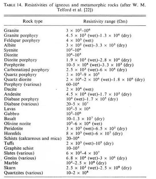

**EDIT: Whoops, \$10^{13}\$ divided by \$10^{-8}\$ is \$10^{21}\$, not \$10^{11}\$. The biggest issue is probably that I should not have used rubber. I had trouble finding good conductivity numbers for dry wood or cured concrete. Wood varied from few gigaOhms when dry to hundreds of megaOhms with just a little bit of moisture content, to few kilOhms when damp. Resistivity of rock is surprisingly low, often much less than 10megaOhms, even when dry.
If you used a few hundred megaOhms, that would cut off about \$10^5\$ compared to using rubber so you would only need \$10^{16}\$ instead of \$10^{21}\$ more area.
