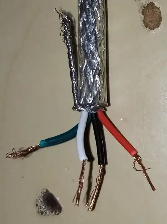

I connected this to my reader and then to my PC's USB port. I opened the Arduino serial monitor and behold my amazement I was reading data correctly. So I thought why couldn't I strip the USB connector and expose the Vcc, GND, TX and RX wires. So I did.
I then connected the Vcc to +5V (Arduino), GND to GND (Arduino), RX to TX and TX to RX. I then opened up the serial monitor after uploading the serial code but still no data. I then changed the RX to RX and TX to TX and still no data.
However, when I connected the serial to USB cable straight to my PC (before striping the USB connector) the serial data was been correctly transmitted and viewed from the serial monitor. So why when I put my Arduino as the "middle man" the data does not go to my PC serial monitor?
The baud rate was 115200. I cannot change this baud rate because it is the spec of the reader. Additionally, I transmitted data successfully at 115200 by using my PC as the host (using Putty at 115200). So the baud rate is not the issue.

  • "before striping the USB connector" What does this mean exactly? What part did you "strip"? One or both ends of that cable has electronics in it, if you cut that off, you basically turned it back into a USB cable... – Ron Beyer Aug 21 '20 at 19:36
    USB does not have TX & RX wires. It has D+ & D- wires. You can't connect those to your Arduino. – brhans Aug 21 '20 at 19:54

The adapter you bought has a USB UART chip with a RS232 voltage level translator inside the DE-9 connector, so the wires you cut use the USB protocol. You cannot connect USB to your Arduino, it will not work.

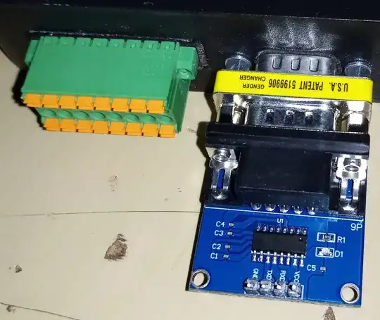

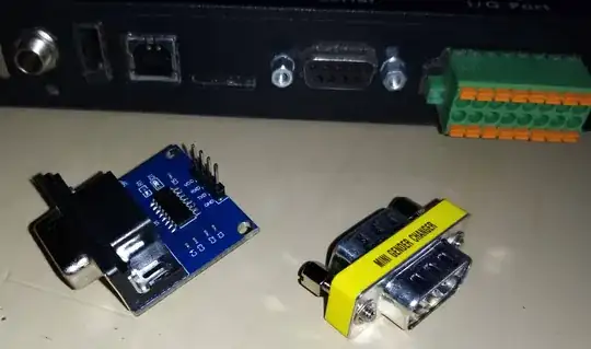

It would be good if you could similarly establish that your Arduino can talk to your PC through the RS232-TTL adapter and USB-RS232 cable - and this step may also require a "null-modem" cable/adapter to swap the TX & RX pins on the RS232 side of the connection between the 2 adapters (NOT on the Arduino/TTL side).
For clarity - the "Gender Changer" adapter you show in the pics is almost certainly not a "null-modem".
You may have to try swapping the TX and RX lines between the adapter and your Arduino, as well as using or not-using a "null-modem" adapter between the TTL adapter and the USB adapter.
Note that there a 4 different configurations here which you may need to try! If you see this working - do not change the Arduino to TTL adapter connections again as this is now the only correct configuration.
If you're not able to complete the above step due to lack of suitable hardware it's not the end of the world, but there's less certainty going forward that you don't have some other issue on the Arduino end of things.
So now you're at the stage where (hopefully) you know that your Arduino can talk through the RS232-TTL adapter. The only piece of uncertainty left it whether or not you need a "null-modem" between that and your RFID reader to swap the RS232 TX & RX lines. There are only 2 options here - either with the "null-modem" or without it. One of those should work. If you weren't able to verify your Arduino comms earlier, then there's also the possibility that you need to swap the Arduino-TTL adapter TX & RX lines - another 2 options. So there are again 4 possible configurations - make sure you try them all!

  • I also have male to female Rs232 cable. Can I use this as a null modem? I did connect this cable the male to the reader and then attached the gender changer to the female end of the Rs232 cable. This female end which is now a male end due to the gender changer was then connected to the Rs232 to ttl converter. But still no data was going through. – JoeyB Aug 22 '20 at 00:58
    You can only use it as a null-modem if is is a null-modem. In the simplest case, a null modem cable swaps pins 2 & 3 over from one end to the other. If you can confirm that your cable does this then you can use it as a null-modem cable, otherwise not. – brhans Aug 22 '20 at 01:01
    It worked! I did not have a null-modem so just use jumpers for now and it worked! The explanation was really helpful. Thank you brhans! – JoeyB Aug 22 '20 at 11:09
given that the USB cable worked the reader is wired as a DCE
augment that gender changer with a null modem adapter and it should work,
