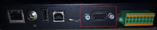

I am trying to communicate with an RFID reader via its serial port. The serial port has an RS232 connector on it. I also want to display the RFID tags ID on a 16x2 LCD screen using an Arduino.

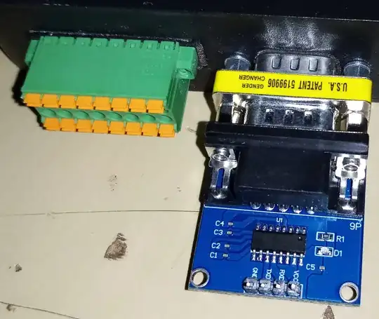

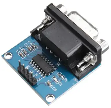

I, therefore, purchased an RS-232 to TTL converter (shown below). enter image description here

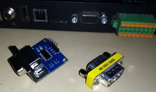

I connected an RS-232 cable from the reader to the converter (male to male RS-232 cable) and then to my Arduino Nano. I connected TX (RS-232 converter) to RX (Arduino) and RX (RS-232 converter) to TX (Arduino).

Most likely there are multiple points of failure here.
First of all, the RS232 to TTL converter TX pin is an input for the RS232 transmitter, so the TX input must be connected to TX output pin of the Arduino. Likewise, the converter RX pin is an output from the RS232 receiver so it must be connected to Arduino RX input pin.
The RS232 to TTL converter DE-9 connector is a female like any other DCE, so the pin 2 is RS232 TX output, and pin 3 is RS232 RX input, and it is meant to be directly connected with straight through cable to a DTE like a PC. So when a DCE is connected to another DCE like the reader, it means that a crossover null-modem cable is needed, to connect TXD of one device to RXD of another device. Simply an adapter will have direct connection and will not work.
Then the final issue is that the Arduino is running at a 16 MHz clock. Also, the clock does not come from a crystal, but a less precise ceramic resonator, which is only accurate to about 0.5% initially and can deviate with temperature to about 1%.
Now, I don't know the details how the softwareserial works, but depending on what other things the program does, it may have problems running at 115200 rate reliably. Even using the hardware UART will not help much, as 16 MHz clock just does not allow for 115200 baud rate below 2% of error in the rate, and adding the ceramic resonator error, it may just result in so large error that it does not work at 115200. Suggested maximum error rate is within 2%.

RXD on the converter header connects to pin R1OUT on its MAX3232; it's an output, and should be connected to the RX input of the Arduino. Likewise, the TXD pin should be connected to the TX output of the Arduino.
Both RS232 ports may also be DCE wired, so you may also need a Null Modem cable/adapter to connect the two.
mbedded
  • 745
  • Removed the cable and added a null modem straight to the converter TTL. swapped the wires and still no data – JoeyB Aug 20 '20 at 23:18
