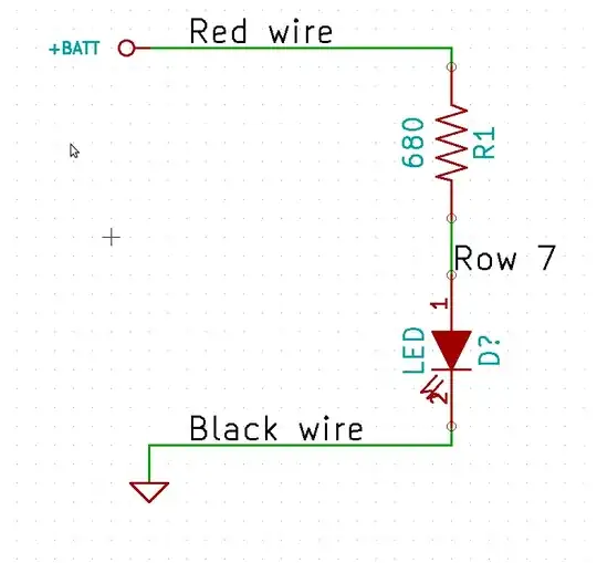

Now let's take a look at the electrical circuit schematic of the wiring in Diagram 3.
LED circuit

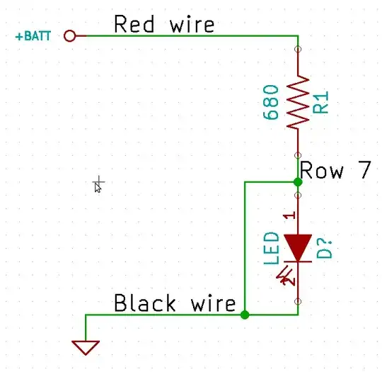

Note how there is a path that starts at the red wire and ends at the black wire. This is the path that current takes from the positive battery terminal to the negative battery terminal. If you were to connect the black wire and the LED as you described, the black wire, the resistor lead in row 7, and both LED leads would all be connected directly together. The circuit would look like this:
This extra connection provides a direct connection from the second resistor terminal (I7) to ground, bypassing the LED. It's a fair bet that the LED won't light up.

It's part of what a breadboard is: there's a strip of metal connecting F7 through J7 together. So plugging the LED into G7 and H7 would short its leads together, resulting in nothing happening.
Similarly A7-E7 are connected together.
