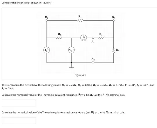

Ok so I'm really new to electrical engineering and I was wondering if someone could help me analyze this circuit using KVL and KCL node analysis. I'm not really sure as to how I can set the KVL and KCL equations up and how I can calculate the Thevenin resistance. Can someone give me some pointers or help me set up my solution?

  • I think this is homework from MITx circuits and electronics series on edx ? because if it is, it is not allowed to be posted like this. Just post your inquiry, not the problem itself. if this is from circuits and electronics repeat the videos to get a better understanding and use a tool called circuits sandbox to simulate your circuits. – Mohamed Atef Aug 07 '20 at 16:34
One way to calculate the thevenin equivalent circuits is to just find the voltages and currents in the circuit. And then solve for the voltages and currents when you short A1, to A2 or short B1 to B2.

  • That isn't what the question asked. – Andy aka Aug 07 '20 at 16:40
  • can you help me set up the Thevenin equations so I can solve it? – John Aug 07 '20 at 16:42
  • To find the Thevenin equivalent for nodes B1, B2 you need to find the voltages at nodes B1 and B2. The Thevenin voltage source value (V) is the voltage between B1, B2. The thevenin resistance (R) can then be found by solving the circuit with B1, B2 shorted and finding the current (I) through the short. The resistance R is then V / I. – user4574 Aug 07 '20 at 16:47
  • @user4574 can u point me to the equations I would need to set up to get the Thevenin resistance? Or just show me how I would do this problem. I'm sorry for making it sound like I want you to do the work for me, I'm just really confused about how to do this mathematically speaking. – John Aug 07 '20 at 17:33
  • I commented above on how to find the Thevenin voltage and resistance if you knew the voltages and currents at each node. But to find that you first need to write a set of equations. One for each node so that you can solve for the voltages and currents. As a hint I will give you the equation for B2. Node B2 has three branches going into it. One through R2, one through R4, and one through R3. Note that the current in R3 is equal to I2. So the equation for node B2 is... (B1 - B2) / R2 + I2 + (0 - B2)/R4 = 0. – user4574 Aug 07 '20 at 17:48

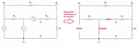

Open-circuit the current sources and short-circuit the voltage sources to find equivalent Thevenin resistance: -
Hence, impedance between A1 and A2 is: -
$$R_3 + R_4||(R_2 + R_1)$$
Can you take it from here and put numbers into the formula then do the same for the impedance between B1 and B2?
Knowing V1, I1 and I2 is not needed for this so don't waste your time pursuing that path. Voltages and currents stated are red-herrings.

  • yessir. so this would be 3.3 + (1/((1/4.7) +(1/19.2))) which would be 7.0757 equivalent resistance. Is this correct? – John Aug 07 '20 at 18:24
  • You don't really need me to do calculator work for you do you? I told you how to do it. How to use a calculator is not a relevant question on this site. – Andy aka Aug 07 '20 at 18:31
  • Nope I think I understand the calculations perfectly. Is (2+1)||(3+4) the impedance between B1 and B2 or am I doing something wrong there? – John Aug 07 '20 at 18:42
  • Nowhere close to being right. Just get a pen and paper and draw out what you see and ask yourself what R3 has to do with any of it. Use your eyes! – Andy aka Aug 07 '20 at 18:55
  • so i thought about it and I have changed my view of this, now it just looks like a series to me so R1+R2+R4 – John Aug 07 '20 at 19:01
  • Incorrect. Try again. Use your eyes - draw it out on paper. One more chance then I'm ignoring you. – Andy aka Aug 07 '20 at 19:03
  • wait one more thing, when you say open, the implies that there is no connection there correct, and short is implying that we just replaced the voltage source with a wire? – John Aug 07 '20 at 19:05
  • Jeez, I drew a picture and put it in my answer. What does the picture tell you? Don't answer because you have only one more answer. – Andy aka Aug 07 '20 at 19:20
