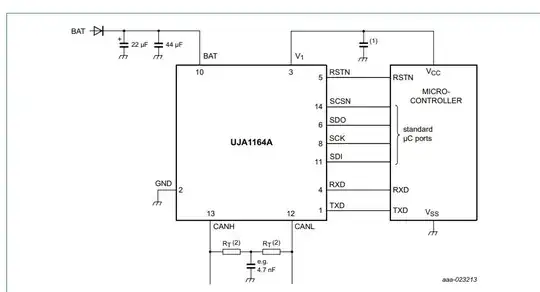

Im looking towards using an system basis IC for one of my designs (UJA1164A) and i noticed that under the features & benefits it notes that
"Battery and CAN bus pins protected against automotive transients according to ISO 7637-3"
i unfortunately don't have access to the sheet so i'm unaware to how far this standard goes, and wanted a second opinion. In either a 12v or 24v automotive application how well would it fare (or at all) with a load dump, especially if we're talking about a 24v system that expects around 170v for few hundred ms without a beefy TVS to clamp it ?
diagram
worst case i was looking to the TIDA-00992 for additional protection or putting in some big boy tvs suggested on here Link
or one of these tvs tvs link

  • From memory, ISO7637-3 is for Signal Lines only, and contains only short sharp low(ish) energy transients. ISO7637-2 is for supply lines, and has Load Dump. For 24V system you'll most likely need a Transzorb, as you say. Do lots of testing, including in-vehicle. Truck power supply is really nasty. – elchambro Jun 12 '20 at 03:50
    http://www.compel.ru/wordpress/wp-content/uploads/2017/05/ISO-7637-22011E.pdf - part 2 and useful info about part 3 – Andy aka Jun 12 '20 at 09:26
