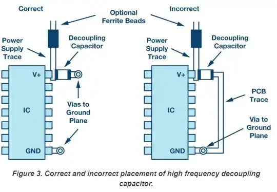

I've started designing my first PCB and I'm trying to figure out how to layout my decoupling capacitors. I've done a fair bit of reading both on here and elsewhere on the internet and I'm still not sure how my capacitors should be connected.
Case 1
Specifically, these (1 and 2) stack exchange posts seems to say that the GND pin should be connected to the capacitor, which is then connected with a via to the ground plane.
Case 2

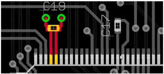

Meanwhile, this post says that we should have the GND pin go directly to the ground plane, like this:
Which of these is right? Or am I misunderstanding something and are they both correct? Thanks!

Given what you've shown, you want to use your first option - vias to the GND plane and no trace.
Problem with option 2 (right most) is the loop & inductance formed by the trace between the cap and the GND pin of the IC. At high enough switching frequencies, this inductance can make it look like the cap isn't even there.

  • Sorry my original post was a bit unclear. I was asking about the difference between case 1 and case 2 (edited my post). In the first of the two stack exchange posts I linked, the comments say that option d (in that post) is incorrect. But option d is exactly like the Case 2 left hand side, as far as I can tell. – Anubhav Srivastava Apr 16 '20 at 01:00

  • In my IC the VCC and GND pin are next to each other. The case 2 image I pulled is not the same as my IC. Assuming the case 2 image had the VCC and GND pins right next to each other, would one of left or right be better than the other? Thanks! – Anubhav Srivastava Apr 16 '20 at 18:39
  • Assuming you have power & ground planes that your IC is connected to, it's better to connect the cap to those planes with vias rather than running a trace to the VCC & GND pins of the IC. – SteveSh Apr 17 '20 at 12:24
It should be noted that on high-frequency ICs VCC and GND pins are usually located close to each other, so case 1 and case 2 become effectively the same. Example:
If you really care about an optimal layout, you should prefer such ICs to what you have in your picture where VCC and GND pins are on the opposite sides of the package.

  • So in this case the GND pin goes to the capacitor and then to the ground plane. Is this better/worse (or neither) than going directly from the GND pin to the ground plane. Thanks! – Anubhav Srivastava Apr 16 '20 at 18:40
  • Having the MCU ground pin go to the decoupling cap and then finally through a vi to the ground plane will ‘let’ the capacitor filter the supply before it reaches the ground. The capacitor will filter out all the high frequency content. – Jakob Halskov Apr 17 '20 at 06:44
  • @AnubhavSrivastava That's correct. More importantly if the total trace length is less than 10mm, it really won't matter that much whether the via or the cap is connected first. The trace inductance separating them will be negligible. – Dmitry Grigoryev Apr 17 '20 at 21:46

The answers on this thread so far all agree that "it depends". I thought it would be worth expanding on the loop area mentioned in some of the replies, because that's the crucial factor here.
It's all about loop area formed by the cap and the chip. Best to understand what loop area is, then you can pick the best compromise for any situation. There is no "just do it this way, always" solution I am afraid.
Loop area is the area formed by the path of the current flowing into the chip from the cap and the path of the current flowing out of the chip back to the cap. Let's call the in path V+ and the return path GND.
For most practical purposes up to say 1GHz frequencies you can just look at the top down loop area (i.e. just draw it on top of your pictures). At higher frequencies you might need to look at it in 3D.
Where you force the currents to flow in a traces, the path is clear - it's the lines of the traces. Where you allow one current to flow on a plane and the other is in traces, the path of the higher frequency currents on the plane will not follow the shortest path (which you might expect) - instead they try to follow the path taken by the current confined to traces. The lower frequency or DC on the plane will flow straight to the supply and miss out the decoupler completely, but these aren't interesting in the context of decoupler placement.
I've annotated your image with the (top view) loop area in each case.
The red solid lines are V+ flows from cap to chip & the red dotted line is the internal current flow through the chip.
The green lines are GND flows from chip to cap. Note for the left hand image the actual path taken by the green line from via to via will depend on frequency - the higher the frequency, the more extreme the divergence from the shortest path as the return current tries to follow the forward current.
The blue areas are loop area. You can see which one is better - it's the one with least blue.
Note I've cropped out the correct/incorrect text - it depends entirely on the application as to whether this is true or not - for certain applications the right hand solution might be good enough and might allow other routing advantages. It is unlikely to be the best solution, though.
Loop area illustration
I hope this helps.

  • I see, this helped a lot. In my IC the VCC and GND are right next to each other so I'm guessing it won't make much of a difference whether I go from the GND pin directly to the ground plane or if I go to the cap, which is connected to the ground plane. The AVR hardware design considerations document by Atmel (https://www.mouser.com/datasheet/2/36/doc2521-41636.pdf) says to connect it like Dmitry's answer, so I think I'll go with that. – Anubhav Srivastava Apr 17 '20 at 23:35
  • I agree. The loop area in Dmitry's layout is smaller than if you try to use a via between chip and cap. – Robin Iddon Apr 18 '20 at 11:13
