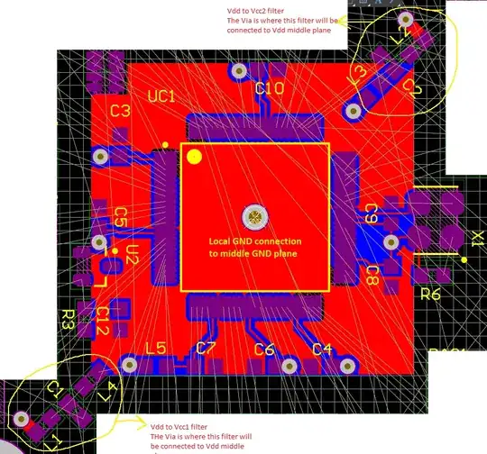

I drew on the picture 2 marks called vcc-1 and vcc-2 , which will become net labels in the pcb desgin.The Board is a 4-Layer stackup (Signal-GND plane-Power plane-Signal) .Now I am lost in what will the power plane be connected to ?
1- power plane is Vdd or cut into 2 parts 1 is vcc-1 and other is vcc-2 ?
2- if Power plane is Vdd, how should Vcc-1 and Vcc-2 be routed? top or in the power plane ?
3-Option #3 : use different 4-layer stack up (Signal+power- GND plane -GND plane-Signal+power) No vdd plane (idea taken from Henry ott EMC book )

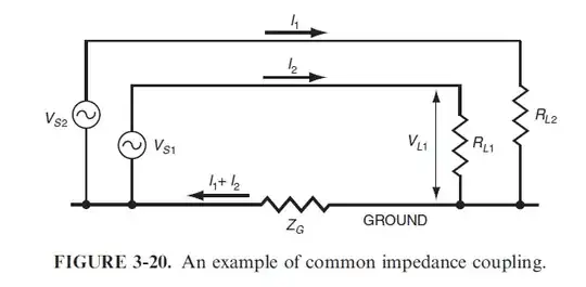

EDIT: There is also a discussion in chapter 3 section 3.2 that discuss Signal grounding and mentions 3 types:
  1. Single-point grounds ( like what you are doing )
  2. Multi-point grounds (like what most people propose)
  3. Hybrid grounds ( a mix between the 2 above as name suggests)
To summarize what the author says:
Single-point is most effectively used at low frequency up to 1Mhz max. It controls how to direct the ground current to flow where we want it. This can be used to decrease noise in sensitive analog circuits. While Multi-point ground systems minimize the ground noise voltage by minimizing the ground impedance which is more important at high frequency digital circuits.
The confusion might be from considering the common impedance coupling shown in figure below EMC compatibility Figure 3-20
In this circuit VL1 = VS1 + ZG * (I1 + I2).
This means that the voltage across the load RL1 is no longer a function of I1 but also a function of I2.
Remember: A high-impedance ground at high frequency is caused by too much inductance while at low-frequency this is caused by too much resistance.
Single-point grounds overcome this by separating ground currents that are likely to interfere with each other and by forcing them to flow on different conductors. This approach is effective at low frequency. However, the signal current paths and long lead lengths associated with single-point increase inductance, which is bad at high frequencies.

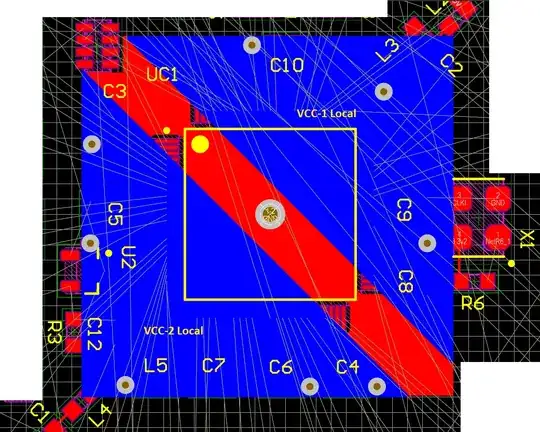

My layout is now like this :
In first image top layer is shown , purple is solder mask (shown here to make capacitor pads clearer ) . The line under C9 is the 24mhz clock . all caps are 100nF 0603.
Second image shows the bottom layer . the 2 triangles are Vcc-1 and Vcc-2 . they are connected to main Vdd plane on the top layer after L-C-L network.
Middle layer are not shown in both images to avoid over crowding the view.

  • Single big via? How much DC current would you estimate passes that via? What frequency AC signals (such as SPI clock) you have on the MCU that need ground currents to pass through that single via? – Justme Apr 16 '20 at 20:15
  • it is just a via , just made it a little bigger (hole=1mm , diameter 1.6mm) to reduce inductance – ElectronS Apr 17 '20 at 00:56
  • The circuit looks fine , however the Power planes on bottom layer seem pointless , you can use thick traces and that would be enough i guess – Sarah Apr 21 '20 at 16:41
