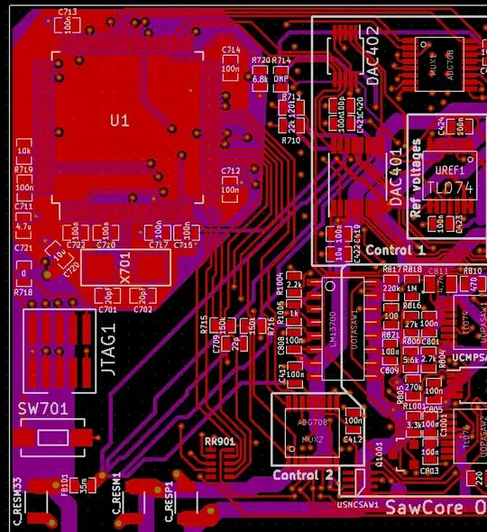

This is a direct continuation of this question. So here's my layout, what do you think about the microcontroller side?

The stack-up is
  • TOP: signal
  • GND: solid ground plane, no cuts or tracks anywhere
  • PWR: power
  • BOT: signal
TOP (red) and PWR (purple) layers, with top silkscreen

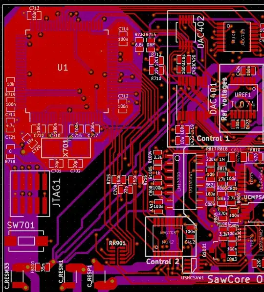

TOP (red) and PWR (purple) layers, with top silkscreen [see update below]

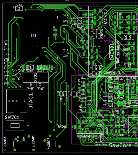

BOT (green), with top silkscreen for orientation
BOT (green), with top silkscreen for comparison to above
The digital/analog split (logically, the ground plane is solid) is left/right here. Power (+3.3 digital, DACs and MUXes, \$\pm15\$ analog) enters on the lower left hand corner, the three caps there are 47uf reservoir caps. A ferrite bead (FB101) separates the +3.3V tracks to the DAC's and MUXes from the uC power. The uC is on the top left hand corner and the plane under it on TOP is local ground, connected to GND with the via near C720.
The uC is an STM32F103VF, and I'll be running it at 72MHz. The crystal is 8MHz. To the right of the uC is the section marked "Control 1" which contains two DACs and a multiplexer, multiplexing the output of the uC's internal DAC1. On the bottom right hand side is another multiplexer near "Control 2", multiplexing the uC's DAC2. The tracks taking the signals from the uC's DACs to an opamp that buffers them (UREF1) before going to the multiplexers are the two tracks going from the vias just to the upper right of C712. The DACs are connected with an SPI bus, which leaves from the upper right hand corner of the uC.
The DACs and multiplexers generate control signals for the analog sound generators to the right (mostly not shown), not audio directly. However, I would expect any significant digital crosstalk in them to be also audible in the generated audio, which would be bad. I'm aiming for a \$1\$kHz control rate, which means that the 8 way multiplexers get new sample values at a rate of \$8\$kHz.
Other tracks leaving the uC are:
  • address selects and enables for the MUXes, from the the top of the uC for MUX1, and the right side for MUX2.
  • PWM signals, going to the resistor array RR901. This is something I'm trying out, essentially generating waveshapes by combining PWM waveforms in certain ways. If this doesn't work, or too much noise leaks through this path, that's ok, I'll just leave it out in the next revision. I'd imagine essentially no noise leaks through this path if I leave RR901 out?
  • an ADC signal coming from the final audio output (not shown) to pin 26 on the lower right hand side of the uC. This is used for calibrating certain features of the analog side, so as long as it gives an effective 10 bits or so of accuracy everything is fine (it's a 12 bit ADC).
  • On the power plane, DAC/ADC reference comes from UREF1 (I don't really need a very specific reference voltage, but I need to have an accurate comparison to what's the maximum output of the DACs).
  • GPIOs going to some of the resistors between the digital and analog sections (for example, R713 and R710) switch various things in the analog section on and off. The R's are accompanied with C's to attempt to filter out any digital noise from the uC, see this question.
  • finally, the RC network R715, R716, C709 filter and attenuate the output of a GPIO, used as a step input to a VCF (not shown) to calibrate it.
Some specific points I'd like to know about:
  1. Is the crystal close enough, and routed well? I had to put the uC analog section decoupling caps in between the crystal and the uC, since that's where the pins are.
  2. C715 is the decoupling cap for VDDA. Note that in order to connect the decoupling cap C717 for Vref+, Vref- tightly, I've had to route VDD to C715 with a rather long track snaking around C717. Is this bad?
  3. VREF- and VSSA go directly to global ground, as do the ground side of the decoupling caps for VREF+ and VDDA. This is accordance to what Olin said in the previous question, so I suppose that should now be ok?
  4. Does this look like there's a chance of a reasonably clean output from the DACs? I'm hoping for about 12 bits effective signal-to-noise. The uC DACs are 12bit, the external ones 16-bit for the prototype (there's a pinout compatible 12-bit version, so I can always switch down later).
Any other comments or suggestions are also very welcome, as I'm not a professional EE so I might also be doing silly mistakes here :)
Update:
I'll collect the latest version according to suggestions here.
Changes on the top layer according to Armandas' suggestions:
  • swap order of C715 and C717
  • increase clearance of top power plane from 6 to 9 mil (any bigger and the plane won't flow through pins, leaving for example C712 ground disconnected)
Updated TOP
TOP v2

  • "mixed-signal" "The digital/analog split (logically, the ground plane is solid)" Uh oh. Normally the two grounds should only connect at a single point. Same with the crystal guard ring. – Ignacio Vazquez-Abrams Jan 10 '16 at 19:56
  • Maybe it's just my bad eyes, but the load caps to the crystal looks unconnected? – Dejvid_no1 Jan 10 '16 at 20:20
  • @Dejvid_no1 their ground side is connected to the local ground plane. – Timo Jan 10 '16 at 20:39
  • @IgnacioVazquez-Abrams the latest rule of thumb on that seems to be that with proper layout, it's better to not split the planes, see for example this. The question I'm asking here is of course whether my layout is proper in that sense. – Timo Jan 10 '16 at 20:40
  • You don't have a continous reference plane for your bottom signals. This will cause E feild lines to fringe much farther than normal, and possible affect other signals, such as your analog. – efox29 Jan 11 '16 at 01:48
  • @efox29 So you're suggesting to do a GND pour on the bottom? – Timo Jan 11 '16 at 08:41
  • Correct me if I'm wrong, but with this grounding approach you will have quite a lot ground loops. Signals will flow through the ground plane and it must go on the via connecting local and global plane. – Bip Feb 02 '16 at 08:26
  • @Bip I agree, as switching frequencies increase (with progress) I have found increasing use of vias to connect various ground planes at multiple points, at thin points of the polygon, near caps, around components and such to provide multiple paths for the aggregate digital ground currents. Perhaps not needed here as the digital currents leaving the uC are small and few. – KalleMP Apr 28 '16 at 21:09
  • I like this layout quite a bit, I wish I could do as well. My slight unease with the layout comes from the long rays of power traces to the analogue sections. I would look to have local groups of components share a trace so they are at the same supply reference, this may not be an improvement but just personal gut feel tells me that any currents in those traces will cause differing volt drops that could cause problems if they are supplying connecting circuit elements. – KalleMP Apr 28 '16 at 21:15
  1. Yes. The traces are very short.
  2. For some reason, you decided to place the cap near the VSSA pin and then run the track to VDDA. I would suggest that you place the cap near VDDA and connect it to the pin with a short trace. The ground pad of the cap should go to the plane through a via. VSSA should be connected to ground with a via. Keep the traces to GND vias as short as you can.
  3. Apart from the above, it looks fine. C717 routing is good.

  • The polygon clearance on the top layer looks quite small. You may want to double check that.
  • Your 100nF and 10uF caps are the same size. Are the bigger caps tantalum?

  • On 2.: I think my logic has been that one always bypasses a pair of pins, a supply pin and a ground pin, and here the pairs would be VDDA and VSSA, and VREF+ and VREF-. It's of course true that simply dropping that logic here and letting the bypass cap and VSSA have separate vias to GND, what you say makes perfect sense – Timo Jan 10 '16 at 21:58
  • Both caps are 0603 ceramic (I'll be hand soldering the board, so I decided to not use 0402's). – Timo Jan 10 '16 at 21:59
  • @Timo Your logic for power pin pairs is good. Another way to look at it is that you want to keep the loop between vias/cap pads and the device as small as you can. In situations like this, where power and ground pads are separated, though, I always put the cap near power pin. – Armandas Jan 10 '16 at 22:04

  • All rails have similar reservoir caps. I guess the $\pm15$ is going to have bigger ones now... BTW: I updated the pics in the question, with C715 and C717 swapped per your suggestion. – Timo Jan 10 '16 at 23:02
