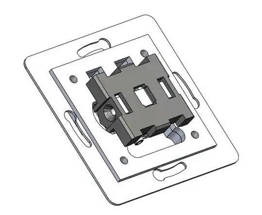

Here comes my project. I've designed and 3d printed a setup that replaces the switch with a plastic contraption that allows mounting of the original switch face plate and that houses 2 micro switches. This saves 15mm of depth compared to the original setup and works great!
my 3d printed jig
