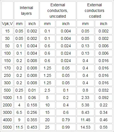

The IPC-2221 standard has this information for you. There is a table, and numerous calculators have been developed so that you can simply plug in your information and it gives you the answers. Here is one such table and here is one such calculator.
Table:
Calculator (image only):

    This answer could be a lot more useful if it showed a screen shot of one tool giving sample results for 1kV or 2kV. – Michael Karas Aug 30 '17 at 01:20
  • @MichaelKaras Excellent idea, one moment please.... – DerStrom8 Aug 30 '17 at 01:27
