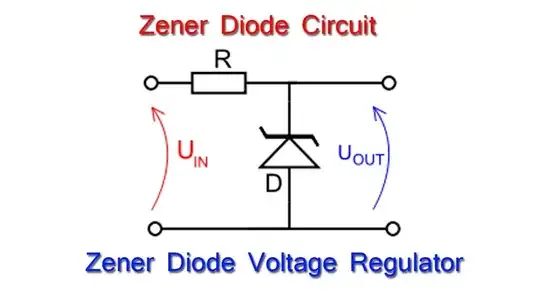

1) When using a Zener diode as the regulation element like in this circuit:
the disadvantage is that the circuit needs to be configured such that there's always some current flowing through the zener diode. The zener diode acts as a shunt regulator, it "burns off" the current that is "left over" instead of limiting the current that flows when little current is needed. When the load takes no current then all the current that isn't taken by the load has to go through the zener. That wastes power. In practice this circuit is only suitable for loads which draw a low current and preferably also a somewhat constant current.
Why would I use this circuit then?
Well, it's cheap.

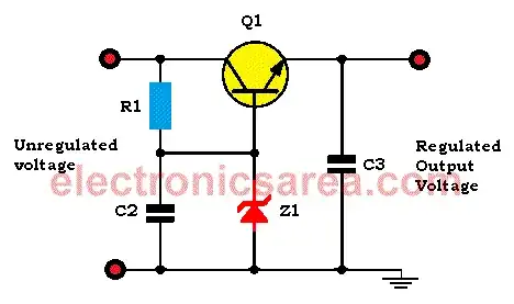

A linear regulator like the LM7805 or a zener + transistor based circuit like this one:
form a series regulator (not shunt). These regulators have the advantage that they consume only as much current as is needed. When the load takes no current then there is only a small amount of power used.
These circuits are slightly more expensive as a transistor is needed or a voltage regulator chip like the LM7805.

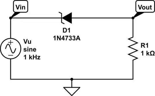

  1. If I understand correctly, this phenomenon will happen only when the Zener diode is connected with the load in parallel. What if I connected my Zener diode with my load in series?
schematic
If you use a Zener diode in series, you will actually deregulate your load. Since the Zener drop (Vin-Vout) will be pretty much constant (if you get to its operating conditions), then the rest of your unregulated source (Vin) will be dropped in your load (Vout), which is opposite of what you want.
