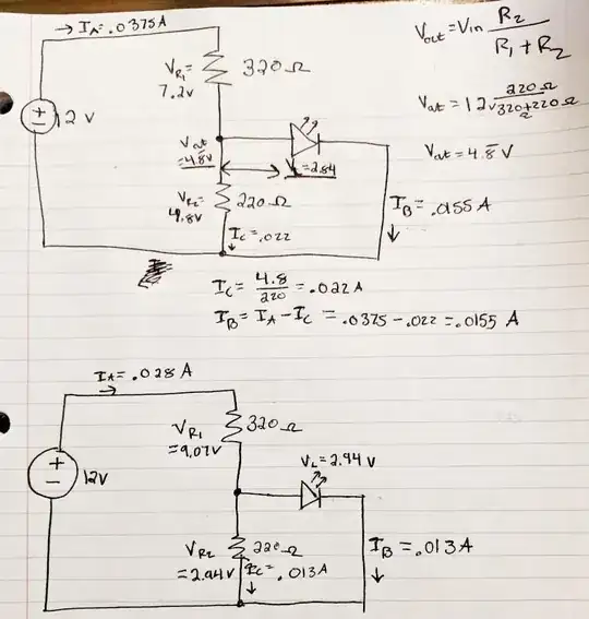

First, I know its not particularly useful to use a voltage divider for an LED, especially with such a big drop, but this circuit is for educational purposes particularly for voltage dividers. It hass been a couple years since I've had circuit analysis so I'm just refreshing myself.
I created this voltage divider circuit with an LED as the load. The top schematic is the calculated circuit, and the bottom is pure measurements. I find I get a big difference between the 2.
**I just noticed a mistake in my calculated currents right off the bat, IA = .0225A, IB = .005A, and IC = .022A. I used 12V instead of 7.2V.
Besides that, my theory on the difference is that the voltage divider will normally end up with a Vout of 4.8V. However the LED has a forward voltage of around 2.84-2.94 V, this extra voltage has to go somewhere so the rest of the voltage will get dumped into R1, which of course will change everything.
Is this a correct assumption? In that case LEDs would be analyzed always as having there forward voltage drop over them (which depends on the current running through them), and calculations go from there (this would further reinforce the idea that voltage dividers are not ideal for LEDs.)
If that is the case, then I could (and probably should) add another resister in series with the LED to soak up the rest of the voltage and set my current correctly.
So to sum up, is my assumption of what's happening correct? If so, is this how it works with just LEDs, or how does actually using voltage dividers with a load work, as most articles only tell you about the voltage divider with no load?

  • if you add an led directly across the resistor it is going to damage because the approximate voltage across the led would be 4.8 V, assuming the LED is going to draw a very small amount of current compare to the series current. – Sayan Apr 23 '21 at 12:40
  • I would've expected the LED to pop but it seems instead R1 picked up the extra voltage. That's what surprised me. I can let it just sit like it is and nothing breaks. – dka13 Apr 23 '21 at 12:44

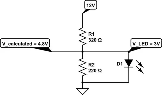

Voltage dividers aren't especially useful for LEDs.
  1. LEDs are current driven devices, not voltage driven devices. Voltage dividers provide a voltage.
  2. Voltage dividers aren't good when there's a load attached to them. The load changes the resistance and therefore the divider ratio.
To make a somewhat stable voltage divider, you need at least about 10 times the current flowing through the resistors as through the load. If your load needs 20 milliamperes, then you will need at least 200 milliamperes through both resistors. At 12V, that makes the total of the two resistors have to be less than \$ \frac {12V}{.2A} = 60 \Omega\$.
If you use that for your 20 milliampere rated LED, though, you will destroy the LED. You'd only have that relatively small top resistor between the LED and the 12V - the LED would get more than 200 milliamperes and promptly burn out.
Your LED didn't "pop" because the current is limited by R1. The maximum current would be \$\frac {12V}{R1 + R2} = 0.022 A\$ That's at or about the rated value of a typical LED. Part of the current goes through R2 and part of the current goes through the LED. R2 diverts enough current from the LED to keep it from burning out.
In your circuit, the voltage at the junction of R1 and R2 will always be the forward voltage of the LED.
schematic
The voltage across the LED depends almost entirely on R1, which control the current to R2 and the LED. R2 reduces the current the LED a little.
If you build the circuit, you will never get the calculated voltage (from the voltage divider equations) across the LED. You will get a voltage that depends on the current through the LED, and the current to voltage curve of the LED (which you can find in the LED datasheet.)

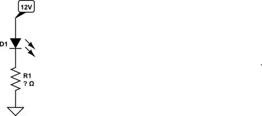

A simple series resistor is all it takes to power an LED from a voltage source.
schematic
simulate this circuit
The datasheet of the LED will tell you the rated forward current (\$I_f\$) and the approximate forward voltage (\$V_f\$) for the rated forward current.
What you do is calculate a resistor value that will limit the current to the rated \$I_f\$ given your supply voltage (\$V_S\$.)
The resistor value is given by: \$R = \frac{V_S-V_f}{I_f}\$
A typical blue LED has a forward voltage of about 3V at 20 milliamperes. You want to operate it from 12V.
\$ R = \frac{12V-3V}{0.02A} = 450 ohms\$

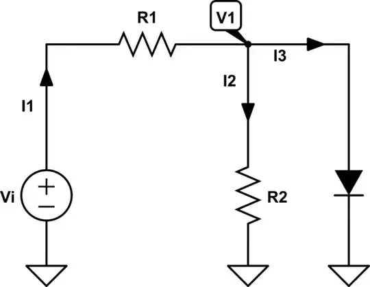

Well, let's make a mathematical closed solution. I know that this is maybe above the OP's knowledge, but I think it is important to show it in combination with the other answers given.
The Shockley diode equation, gives the relation between the voltage across and the current trough a diode:
$$\text{I}_\text{D}=\text{I}_\text{S}\left(\exp\left(\frac{\text{q}\text{V}_\text{D}}{\eta\text{k}\text{T}}\right)-1\right)\tag1$$
Well, we are trying to analyze the following circuit:
schematic
When we use and apply KCL, we can write the following set of equations:
$$\text{I}_1=\text{I}_2+\text{I}_3\tag2$$
When we use and apply Ohm's law, we can write the following set of equations:
$$ \begin{cases} \text{I}_1=\frac{\text{V}_\text{i}-\text{V}_1}{\text{R}_1}\\ \\ \text{I}_2=\frac{\text{V}_1}{\text{R}_2}\\ \\ \text{I}_3=\text{I}_\text{S}\left(\exp\left(\frac{\text{q}\text{V}_1}{\eta\text{k}\text{T}}\right)-1\right) \end{cases}\tag3 $$
Substitute \$(3)\$ into \$(2)\$, in order to get:
$$\frac{\text{V}_\text{i}-\text{V}_1}{\text{R}_1}=\frac{\text{V}_1}{\text{R}_2}+\text{I}_\text{S}\left(\exp\left(\frac{\text{q}\text{V}_1}{\eta\text{k}\text{T}}\right)-1\right)\tag4$$
For the LED, let's use parameters taken from a Luminus PT-121-B LED: \$\eta=8.37\$, and \$I_\text{SAT}=435.2\:\text{nA}\$. (Assume \$V_T=\frac{\text{kT}}{\text{q}}\approx 25.2617\:\text{mV}\$, of course.)
Using the known values, we find:
$$\text{V}_1\approx2.27078\space\text{V}\tag5$$

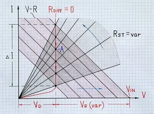

Representation
The operation of the circuit of a resistor and diode in series can be graphically illustrated by superimposing the IV curves of the two elements (the so-called "load line" technique).
LED as dynamic resistor_1000
I have added the IV curve of the variable resistor to show the mechanism of the dynamic resistance (see my explanations in the links above).
This graphical representation can be even used for calculation (and it was widely used in the past since the analysis of such non-linear circuits is complicated).
When another resistor R2 is connected in parallel to the diode (voltage divider), we have to combine two IV curves - R2||LED or R1||R2 (Thevenin).
