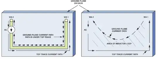

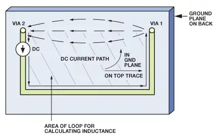

Here is a small summary: Consider a multi-layer PCB with a ground plane according to the following. The DC current returning from via 1 to via 2 through the GND plane will take the shortest path, as it has the lowest DC resistance. However, high frequency signals (e.g. noise) experience not only the DC resistance, but also the reactance due to the inductance of ground.
image_1

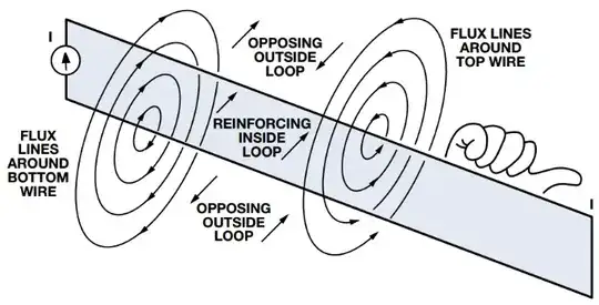

This parasitic inductance is proportional to the loop area formed by the traces and ground plane as shown in the following image. Using the "right hand rule" you will find out that the current flowing towards the load and back to the source through the ground, generates an in-phase magnetic field inside the loop.
image_2
Essentially, the larger the loop area is, bigger the parasitic inductance and high-frequency impedance are. However, the high frequency signal does not have to take this highly reactive path, it can ,and will take a path with the minimum reactance, meaning the one which forms the smallest possible loop, according to the following:
