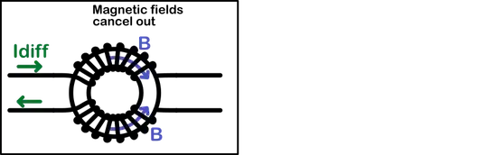

Differential Mode Signals
Differential currents (driven by differential voltages) create equal but opposite magnetic fields B in the inductor core:
These magnetic fields cancel each other out, so the net flux in the core is zero. As such, these differential currents don't "feel" any impedance.
Common Mode Signals
In contrast, common mode currents generate equal and additive magnetic fields in the core. That's why they "feel" a high impedance, and cannot get through (or getting through means they are highly attenuated).

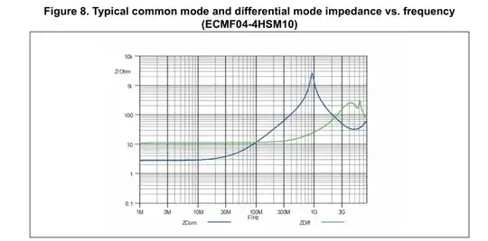

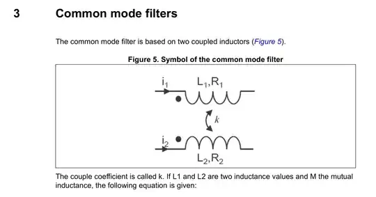

For ordinary common mode chokes, the differential mode impedance reduces essentially to the wire resistances, whereas the common mode impedance is largely inductive, with the wire resistance as a small component.
Since the higher the inductance, the higher the common mode signal attenuation, the goal is to have higher inductance. This leads to designs that aim at avoiding core saturation and core losses, hence, even taking into accounts non-linearity from the ferromagnetic core, an ordinary, two-winding, common more choke presents an essentially inductive impedance to the common mode signal.
Therefore very little power is dissipated inside the choke, hence the common mode signal is essentially "reflected back" from where it came from (theory #2 of yours).

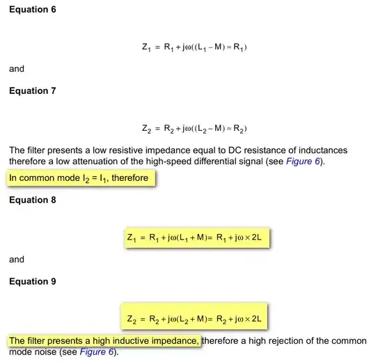

See this relevant document from ST:
In particular these excerpts (emphasis mine):
Just to be explicit: the fact that an inductive impedance implies reflection toward the source depends on the conservation of energy principle. Since there is essentially no resistive component that can account for the common mode signal energy to be dissipated (converted into heat), that energy must go somewhere else: it will be (temporarily) stored in the magnetic field that builds-up in the choke and reflected back from where it came.
However, a real CM choke will have a more complex behavior, primarily because of parasitic capacitance, and show a resonance peak in its impedance magnitude, as shown here by the blue curve (from the same document linked above):
  • Interesting, thank you very much :-). I just don't understand the figure below. Why is the blue curve - the common mode impedance - only 3 Ohm for frequencies below 30MHz? In fact, for these frequencies the differential mode impedance seems to be higher than the common mode impedance. That's weird... – K.Mulier Jul 27 '17 at 12:36
  • @K.Mulier That's not weird if you understand the equations in the excerpts above. From Eqs.8,9 we see that for low frequencies, i.e. f&toward;0, Z1diff=R1 abd Z2diff=R2. From Eqs.6,7 we see that Z1cm≅R1 and Z2cm≅R2. This last approximate equality is better approximated as the coupling coefficient k nears 1, which is only theoretical. If L1 and L2 don't match M, then Z1cm will be greater than Z1diff. The same holds for Z2. BTW, we are talking about impedance magnitude here. – LorenzoDonati4Ukraine-OnStrike Jul 27 '17 at 18:49

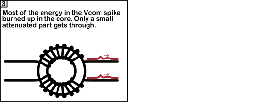

Below is a picture that should help. A single input and output is shown that demonstrates the different impedances you get when you reverse the direction of one of the currents.
The first scenario is for a common mode current that we would seek to block: -

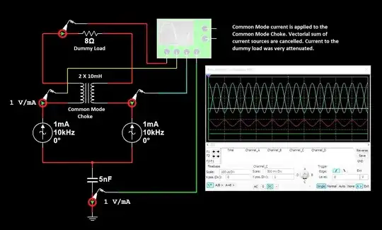

Simulated in NI Sim
Simulated using NI Sim

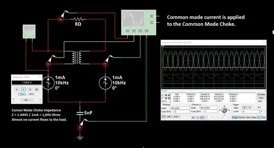

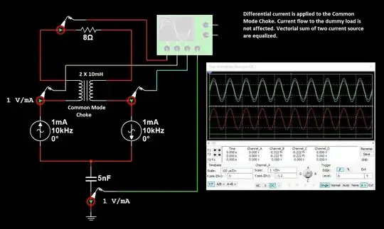

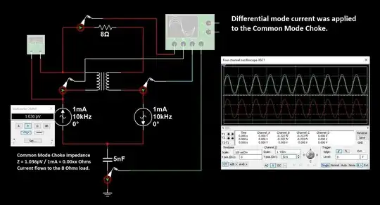

Here is a sim that shows how the opposing electro magnetic flux in the choke creates a high current resistance or impedance.
Common mode current
