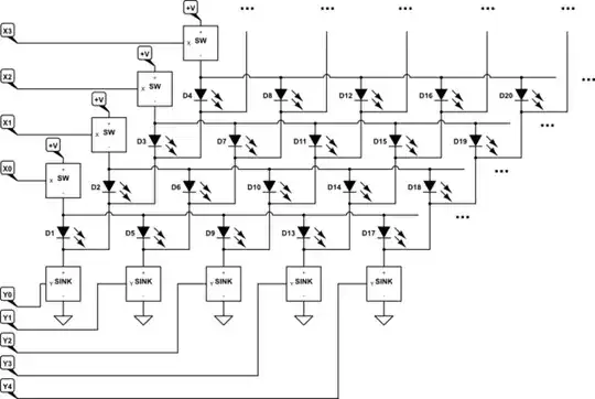

General Approach
In general, the multiplexing approach looks like this:
schematic
(The above schematic shows high-side switches with low-side current sinks. It could just as well have been low-side switches with high-side current sources.)
The \$X_i\$ lines are switch-enable lines. No more than one of these should be enabled at a time. These switches must be able to carry the entire sum of the multiplexed, over-driven LED currents in their group, as you may enable zero, one or all of the \$Y_j\$ current-sink lines when a particular \$X\$-switch is turned on.
These \$X\$-switches have to support that maximum current sum and do it without dropping much voltage. There are two primary reasons for this.
  1. Keeping the switch voltage drop as small as possible allows you to use a lower voltage rail magnitude. This means a lower supported wattage for the power supply. Which means cheaper, easier, better, etc.
  2. Keeping the switch voltage drop as small as possible means less wasted dissipation in the switches (which means smaller heat sinks, less airflow required, cheaper parts, etc.) and in the current sink sections (which again means cheaper, easier, better.)
(The \$Y_i\$ lines are current-sink-enable lines, of course.)
