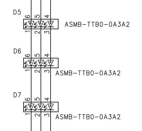

What I’m looking to do is drive a sting of RGB LEDs (independent elements), where each string (Red / Green / Blue) is controlled via a switch-mode controller. In essence, each string is controlled via a constant current source. Thus, there will be three controllers: one for the red string; one for green string; and one for blue string.
Schematic Snippet

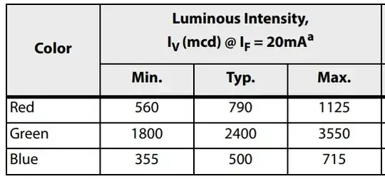

LEDs are far from perfect. This is to say that, when comparing one LED to the next, luminous intensity across the elements (for a given current) will be different. Particularly, the LEDs I’m looking at (ASMB-TTB0-0A3A2) employ the following luminosity spectrum (@20mA).
Luminous Intensity of RGB Elements for LED ASMB-TTB0-0A3A2
To make this a bit simpler, let's assume we have only two LEDs. Let's also assume that we have determined the normalized amount of current that needs to be pumped through the Red and Green elements in order to emit a perfect amber color. The main question is, when considering the worst-case luminous variance between the two LEDs under test, can the difference in color be perceived?

  • @cguenther0929 What are you trying to achieve? Do you want every RGB LED in the string to look as though they are both the exact same color as well as brightness to a human? Or are you doing something else? You use the word "luminous" which implies a human instead of "radiance" which is a physical measure independent of humans. So I'm uncertain of your goals here. Also, contrary to what mguima wrote, the color differences between LEDs from the *exact same* wafer will look different to a human when driven with the exact same currents. So I've no idea what planet that comment comes from. – jonk Aug 04 '20 at 17:57
  • Jonk, yes, I’d like brightness and color of all LEDs in the string to appear the same to the human. Color takes priority over brightness. I realize there will be differences, but are said differences inconspicuous enough? I’m essentially making a bar of light (12 LEDs). All LEDs are close to each other in a single file line. Ostensibly, if two LEDs operating next to one another were experiencing worst-case extremes, it would definitely be noticeable, but I’m not sure how likely such an edge case is. The row of LEDs sits about 0.5” behind a clear overlay (long/narrow) window. – cguenther0929 Aug 04 '20 at 19:21
  • @cguenther0929 I spent years with Siemens/OSRAM (before Siemens sold OSRAM) doing RGB LED calibration work. You can see one of many modules I worked on in this answer, for example. The spacing is close on these modules and it was very important that they look similar to each other in the displays. Separately, I worked on other products designed to "bin" LEDs according to brightness and color (both were required, so this was a 2D binning matrix.) So I know a few things. What you are suggesting wouldn't fly. But the needs may be different. – jonk Aug 05 '20 at 00:21
