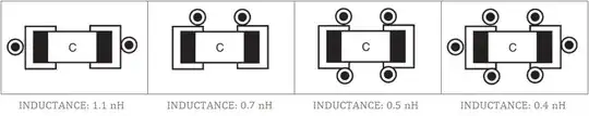

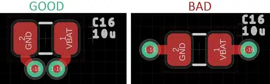

1. Via positioning
I've learned from several sources that the best via positioning is close to each other. This way you minimize the loop inductance for currents flowing between the capacitor and the Gnd/Power planes. enter image description here
The best article I found on this topic is Via configurations for connecting decoupling capacitors from All About Circuits (see https://www.allaboutcircuits.com/technical-articles/different-via-configurations-for-connecting-decoupling-capacitors/). A figure from that page:

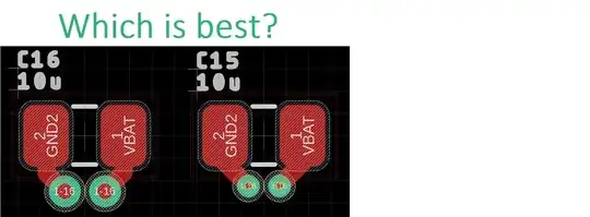

2. Via size
I don't know how to choose the ideal via size. I know that small vias have more resistance and higher self-inductance. This is what you can calculate with this online tool: http://referencedesigner.com/rfcal/cal_13.php
But smaller vias can be positioned closer to each other. The loop inductance is therefore much smaller.
Thank you @Huisman to point out that my big and small vias (see details in next paragraph) are in fact equally spaced if you measure their distance edge-to-edge: Both have 0.175 mm annular ring size and 0.125 mm clearance.
However, if you rely on the center-points for distance measurement, they are no longer equally spaced. So it depends on how you measure the "via distance".
So what is actually the ideal via size, to maximize the effect of the capacitor? Suppose that the ideal via size is rather big, I'd like to know how much extra impedance I cause by choosing for the small via anyway. In other words, is it worthwile to go for the bigger vias?

Normal via
 - Via diameter:      0.7 mm [27.56 mil]
 - Finished hole diameter:   0.35 mm [13.78 mil]
 - Annular ring:       0.175 mm [6.89 mil]
 - Minimal clearance:     0.125 mm [4.92 mil]
Small via
 - Via diameter:      0.5 mm [19.67 mil]
 - Finished hole diameter:   0.15 mm [5.91 mil]
Please help me to choose which via is best to connect the capacitors to the Gnd/Power planes.

    Are you sure the distance is different? I'm not a specialist, but if the current runs from/to the the VBAT pad to its connected via, circles around the drill for 180 degrees and goes down there (so left of the drill) and the current from/to the GND pad the same story, then the small vias and big vias are equally spaced: annular ring of via GND + minimal clearance + annular ring of via VBAT – Huisman Nov 08 '19 at 20:28

You did not mention the frequency range that has to be considered, but I can tell that from a practical point of view, it this does not matter at all.
Especially with a 10uF capacitor, the inductance change caused by the routing differences is so negligible that you should be safe just not to care.
But in a theoretical approach one could argue like this: If the frequency is very low, the resistance is more important so you should go with the normal via. But if frequency is extremely high, then inductance is important and you should go with the small via.

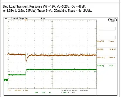

To prove this, let me demonstrate MURATA's PCB layout design, who are one of the best suppliers with attention to RF details such as S-parms or scattering parameters capacitors to either minimize ESR or raise SRF or add ESR to prevent anti-resonant amplification of RF current.
The IC SMPS regulator is shielded and in-out bulk caps are external to this circuit.
On the right side CAD layout , I have added colors to demonstrate Red V+ and Green= Gnd Zones are on the same side without local vias on a 4 layer 1oz copper FR-4.
Murata's results for this 2.5A variable DC voltage from 1 to 5.25V are shown below with input = 13.5V
  • 50%Imax to 100% to 50%Imax results in +/-20mV glitch
  • Vac Ripple at 50% Imax is only 5mVpp
Most people expect 50mV ripple and this design is only 5~6 mVpp or so.
I suggest you use this PCB design as your benchmark for reverse engineering PCB layout geometry, orientation , shielding and ground. The thermal design is also important.

Your proposed via configuration does not minimize the loop inductance. This is because the cost of the tracks on the signal layers is way higher than the cost of traveling the same distance on the power planes. Make sure that the vias are placed such that the track is perpendicular to the pad. A track at 45 degrees is about 41% longer.
Consider the following configuration.
Connection impedance
source
The measured inductance, as given in the source, is (nH) 0.61, 1.32, 2.00, 7.11, 15.7, and 10.3 for configuration A, B, C, D, E, and F respectively.
As you can see, it is best to put the vias as close as possible to the pads. Multiple smaller vias are better than one large via. The smaller vias may have higher inductance, but this is more then compensated for by having multiple connections in parallel.

  • Hi @user110971, thank you for your answer. I agree that positioning the vias close to the pads is very important, and having multiple vias in parallel is a significant improvement. However, I disagree that my "proposed via configuration does not minimize the loop inductance". Please have a look at this article for more info about optimal via positioning: https://www.allaboutcircuits.com/technical-articles/different-via-configurations-for-connecting-decoupling-capacitors/ – K.Mulier Nov 09 '19 at 06:40
  • @K.Mulier Are your vias as close to the pads as possible? It’s hard to tell from your image. – user110971 Nov 09 '19 at 07:16
  • they are indeed as close as possible. Placing the via even closer to the pad would interrupt the soldermask between them, causing trouble in the soldering process. However, I could shorten the track from the pad to the via in the figure on the left (capacitor C16). – K.Mulier Nov 09 '19 at 09:12
  • @K.Mulier However if you increase the distance between the vias, you can shorten the track. A track at 45 degrees is about 41% longer. Look how they have placed the vias in your link. They are located such that the track can be perpendicular to the pad. – user110971 Nov 09 '19 at 11:07
  • You have a point @user110971 – K.Mulier Nov 09 '19 at 11:46
