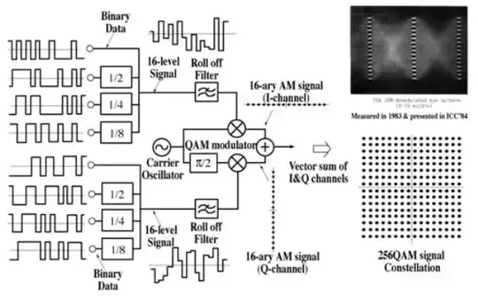

Nowadays, analog communication not only use amplitude, but phase information to stuff even more bits in a communication clock cycle, as illustrated in This topic (Disclaimer: I have one answer there, but it's the only topic I can remember of which discusses this). And this is only a mere example of a plethora of techniques that become more and more complex with every year that goes by.
