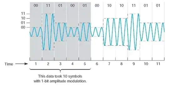

I'm surprised people only mention modulation (the process that modifies a higher energy "carrier" that can be radiated easily over long distances in function of the signal) as an additional factor rather than a key element in increasing the datarate of communications links. Remember those 54kbps modems at the beginning of internet? When the ADSL modems kicked in, there was an immediate twentyfold+ increase in datarate, mostly due to the modulation used: with QAM, the bitrate became higher than the symbol (clock) rate (by using various amplitudes and phases), like fitting more things in the same bucket travelling at the same speed, just by figuring out a cleverer way to arrange them. And we're not done yet, many others already exist or are being investigated...
a) States map of QAM modulation, one of the RF modulations b) How symbol rate can be different from datarate, example with multilevel amplitude modulation (the ancestor of FM), one of the components of QAM (the other is the phase, very related with FM).
