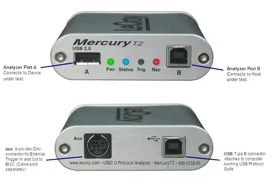

Usually I either use a CATC analyzer like this. enter image description here

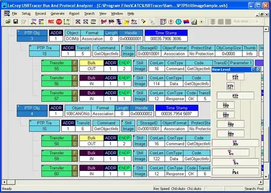

The nice thing is you get great software that shows you exactly what's happening:

You might also try checking ebay for CATC analyzer, or you could rent one. Making a Y cable won't work out though as you already found :)

  • Thanks a lot for the detailed answer @SHG. I understand how the CATC can help, but the final product will not be able to incorporate such expensive gear and will have to be based on some "magical" wiring + proprietary software on the sniffing PC. Is there not a way to send only the data to a 2nd PC? – zulfik Oct 28 '12 at 15:36

  • Ah ok not a small undertaking then :) If you look at how the CATC does it they usually have an FPGA in there that's snooping the lines and decoding the protocol for them. Then they're storing all that information in local memory. Once their capture buffers are filled up or there's a trigger the PC grabs the raw data for analysis. I don't see a way that you'll be able to just connect some cables up to the second PC without some sort of custom hardware in the middle. – Some Hardware Guy Oct 28 '12 at 18:33
