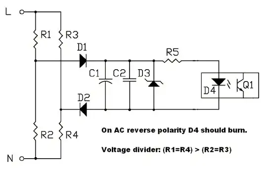

How can I detect AC 'reverse polarity' (single phase) (without the use of ground/earth) and drive a led when the polarity is reversed?
It should at least detect 230 VAC but it would be cool/informative for future readers if the solution could work in US and EU (approximately 120 VAC to 250 VAC).
I did find this (non-isolated!) circuit, but I can not get it to simulate (the simulator complains that it needs ground or the LED blinks on both halves of the wave).
ac polarity detection ?
Source: 1 & 2
My questions are then:
  • Is the above schematic really functional and how does it work?
  • Is there a better or alternative way (MCU or perhaps even an IC) that does this?

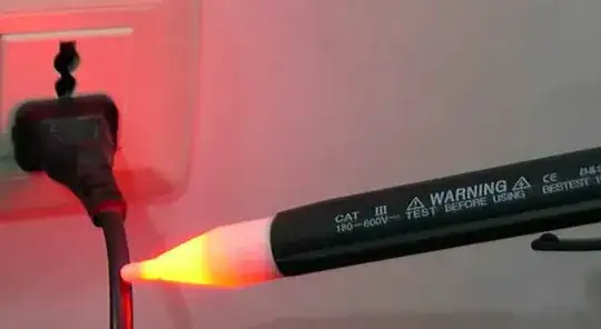

As other posters have suggested, this can't be done via conductive measurement alone. However, non-contact AC testers will properly differentiate line from neutral without a reference ground via capacitive sensing. This type of hand-held tester often has a flat plastic blade at the tip. Inserting the blade in the line slot will cause the LED to glow; inserting in neutral or ground will not glow:
There are a number of kits for this type of circuit, as we as many sample schematics available in a few minutes of searching (Search string: non-contact ac voltage detector circuit). They're essentially just high gain amplifiers that drive an LED.
Using this type of sensor permanently mounted near the Neutral line can serve as an indicator that your plug has been inserted the wrong way, provided that you have a reliable way (i.e. not battery) of powering the circuit.

  • I saw schematics of this thing, but it's not what I need, thank you none the less! – zduk Oct 11 '12 at 03:54

  • Could someone test if this contact-less detector (as displayed in this answer's picture) works correctly without it laying on the ground or a human touching it? – zduk Oct 13 '12 at 15:15

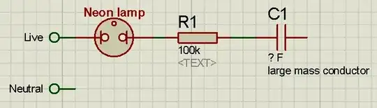

Usually C1 is our body which has a large capacitance, but a simple piece of metal, a wire, a conductor with a large mass, will work as well.
The larger the mass, the larger the capacitance, the brighter neon lamp gets.
Normal large value caps wont work. This is electrostatic, only the mass of the conductor determines the capacitance.
I was able to slightly light up a NE-2 type neon lamp with just a 60cm wire attached as C1.
Update: After giving it a second thought I realized is not the mass that counts, it's the surface area that matters. You are effectively forming one plate of the capacitor while the other plate is the ground.
But principle is the same, you need a large conductor hanging loose to capacitively couple the AC voltage to ground.
