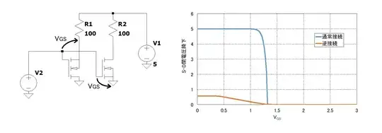

The circuit shown below is implemented using two AO3400 N-MOSFETs.
AO4300 datasheet here.
The right-hand MOSFET is connected with normal polarity (Vds is positive),
while the left-hand MOSFET is connected with reverse polarity (Vds is negative).
The graph at below right shows the relationship between Vgs and Vds simulated by LTSpice.
The blue curve is for the normally connected FET, and
the orange curve is for the reverse connected FET.
At low Vgs (<< Vgs(th)), the reverse connected MOSFET is conducting due to current in the body diode, resulting in a Vds value of about 0.6 V. As Vgs increases to above 0.4V , Vds starts towards GND level.
Why does the reverse connected MOSFET starts to turn on from about Vgs = 0.4 V when this MOSFET has about 1.1 V threshold?

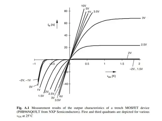

The results that you are seeing are due to (well known to industry but less known in popular understanding) assymmetric behaviour of MOSFET Vgs / Ids characteristics at Vgs values both around and below Vgs(th)_forward.
Specifically, Vgs(th) may be effectively lower o even vey much lower when Vds is negative (but necessarily <= Vf(body_diode) and Ids_max may be very substantially higher for a given Vgs when Vds is negative. This is exactly the results that you are seeing.
  • Examination of Fig A.1 below and the related text provides an essentially complete description show WHAT you are seeing happen.
  • For a description of WHY (for the brave :-) ) see the cited reference and related material below.
Note that while the paper indicates that the information relates to TRENCH MOS devices it also notes
    This characteristic behavior is not exclusive of trench MOS technologies
    as it may also occur in other types of vertical MOSFETs such as DMOS,
    CoolMOSTM, and planar structures.
Their following summation explains what you are seeing.
Note that the numerical values relate to the device they are dealing with and are similar in nature but somewhat different in absolute values to your example.
"From the measurement results it can be observed that:
  • The body diode forward characteristic seems to be modulated by voltage Vgs in the sub-threshold region, even at negative Vgs values down to 1 V [for the device in question].
  • At a given Vgs in the threshold region (i.e., voltage Vgs close to Vgs(th)), the drain current magnitude in the third quadrant is much larger than that in the first quadrant, also at low Vds. For instance, at Vgs = 2 V and Vds = -0.5 V the drain current reaches 40 A. In the first quadrant however, the maximum drain current at the same Vgs is about only a few amps.
  • A symmetric characteristic between the first and third quadrant appears ... at high Vgs.
_____________________________________________
This 15 page appendix Third Quadrant DC Output Characteristics of Low Voltage Trench MOSFETs* provides a useful introduction to the subject, and there is much other material available 'on web'.
  • *In text T. Lo´pez et al., Voltage Regulators for Next Generation Microprocessors, DOI 10.1007/978-1-4419-7560-7, # Springer ScienceþBusiness Media, LLC 2011
The following quotes (edited for brevity) are drawn from the above text:
  • In the following subsections the third quadrant output characteristics is described in more detail by looking at the internal structure of the device and analyzing the origin of this significant reverse current conduction.
  • Semiconductor manufacturers typically specify the DC output characteristics of power MOSFETs in datasheets, ... Yet, such specification only refers to the operation in the first quadrant, ... . Regarding the third quadrant, i.e., voltage Vds is negative, only the body diode forward characteristic is usually specified for zero volts Vgs. No further information about the channel current in the third quadrant and its Vgs dependence is provided.
    In circuit simulations ...
    • it is usually assumed that the first and third quadrants are symmetric
    • and that the body diode forward characteristic is independent on vGS [1, 2].
    As shown in Fig. A.1, such assumption is not always valid. The plot depicts experimental results corresponding to the output characteristics of an N-channel power trench MOSFET (PHB96NQ03L)
Your device behaviour for comparison.
If the device behaved symmetrically you would expect the 'yellowish' body diode limited curve to extend out until about Vgs(th)_forward at about Vgs = 0.6V

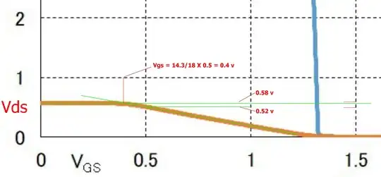

  • @Sano ... Note that The reverse FET curve that you posted shows Vds of about 0.2V at Vgs = 1V. This means that V across 100 Ohms is (5-0.2) = 4.8V so Ids is about 4.8V/100 Ohms = 48 mA. This is far far far above Ids at Vgs(th) - so actual Vgs(th)_reverse must be much lower than 1V.. . The paper is EXTREMELY useful and answeres your question well. – Russell McMahon Aug 26 '19 at 09:49

The "problem" is several fold. Some of these points look to be "nit-picking" (trivial and/or exaggerated) and to some extent they are - but your question, while a good one, also falls in the same category and we have to look at 'all the little things' to see possible causes. Ultimately, you are trying to extract very small precision data from a device at an extreme end of its operating range where either no expectation of precision applies and/or very small effects become significant.
  • Your results are simulated.
    What happens with a real world physical device?
    How good is the simulation?
    How do you know?
  • The datasheet tabular and graphed values are typical. Even a typical minimum is still typical unless stated otherwise. Table values for min/max usually are taken as hard limits as long as related conditions are also met. Graphs are almost always 'typical'.
  • It is common to look at the datasheet min / typ / max values for Vgsth at a given Ids and misapply them to what we are typically seeing in the circuit under observation. And the related datasheet curves (here figs 1 & 2 on page 3 of the datasheet) are essentially useless when peering at so low current low voltage regions of operation. The tendency is to TRY to apply them and to come up with "zero" when that is not the right answer.
    The graph in fig 2 suggest Ids ~~ 0.000 for Vgs <= about 1.4V - but where would you plot Ids = 100 mA on the Y axis ? :-).
    • In the datasheet on page 2 Vgs(th) is specified as 0.65 1.05 1.45 V min / typ / max.
      This is NOT " ... Vgs is far from Vth ..." as noted in a comment. BUT in looking at the data sheet value an extra specification has to be noted. The given V_gs(th) is for Vds = Vgs, Id = 250 uA. Here, for the forward connected MOSFET Vds is about 20 times higher than then Vgs (5V & about 0.5V) and for the reverse connected MOSFET Vds/Vgs is high for very low Vgs (Vds ~= 0.58V due to diode for 0 < Vgs < 0.5V) and still about 50% higher (0.58V) as the MOSFET starts to conduct visibly as Vgs - 0.4V.
  • The simulation values may be optimised for typical currents which are say 0.1 - 5A and maybe 1-50A (see datasheet graphs) while here we are dealing with around 50 mA and deltas of around 500 uA.
  • The real world part may be better than the datasheet over time, as happens, this being a 2011 datasheet. So they MAY have adjusted the simulator and not the 8 year old datasheet. Which would be naughty. But happens.
    Or, the simulation values may not track the datasheet and/or real product precisely and at this level the effort required to make the model better may bot be deemed important enough.
  • The datasheet Vgs / Vds graphs are only stated as being for operation in the 1st quadrant. As you know, for a N Channel MOSFET (such as this) Vgs must always be positive for MOSFET enhancement but Vds can have either sign. But, there is no certainty that the device is absolutely symmetric electrically either for reversed Vds polarity, or for Vgs polarity with respect to Vds. If the differences were large and/or important the manufacturer would hopefully say so - but even that is not a certainty. As Vds with reversed polarity is restricted to the range of 0 to somewhere under 1V due to the body diode, the reverse Vds quadrant is usually of limited interest. But not in special cases, such as this one.
The graph below (taken from a blowup of you one) shows my interpreted / interpolated values for a number of key points. I have calculated currents at various points and relative effects of body diode and channel resistance as the channel starts to visibly conduct. I have not added them as this has already taken longer than I hoped. The above may provide enough ford for thought. If any sounds worth pursuing questions are welcome.

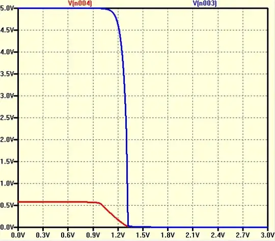

I use this one http://www.aosmd.com/products/mosfets/n-channel/AO3400
And get this results:

  • @Sano Until V2 voltage is lower than Vht the bod diode is ON and conduct current. Right? But at the time when V2 > Vth MOSFET normal (channel) current begins to flow. And MOSFET shorts out the diode current. – G36 Aug 25 '19 at 15:00
  • But Vds is start to drop down at 0.5V even though Vgs is far from Vth. – ssa2 Aug 25 '19 at 15:03
  • Do you have a MODEL for AO3400? – G36 Aug 25 '19 at 15:12
  • Yes. I got it from website – ssa2 Aug 25 '19 at 15:13
  • See my graph from LTspice. – G36 Aug 25 '19 at 15:16
  • I think it is Vgd-Vds graph, not Vgs-Vds. – ssa2 Aug 25 '19 at 15:25
  • Oh, this result represents MOSFET can be turned on by Vgd, not only by Vgs. Why? Source and Body is connected, so Vgs=Vgb then chanel is appear, but drain is not connected to body ,so Vgd can't apply voltage between gate and body. Why Vgd can turn on MOSFET? – ssa2 Aug 25 '19 at 15:30
  • >I think it is ... This is about the graph of reverse one. – ssa2 Aug 25 '19 at 15:58
  • The on-state characteristics of a MOSFET are symmetric. And simply now the drain act as a source and source as a drain. Why it is true I don't know. You need to ask about it semiconductor physicist – G36 Aug 25 '19 at 16:07
